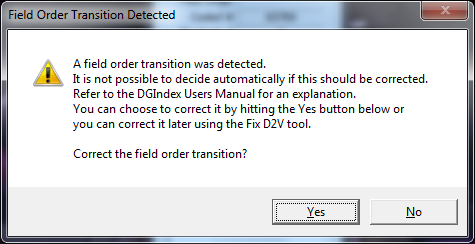

    Yes it sounds like you have errors. Did DGIndex throw some errors when you indexed it? You could also try with tsmuxer to cut segments
    It indexed ok, but at the end it gave this error:
    You could try projectx , tsdoctor, or pvastrumento to fix it , or even videoredo's quickstream fix
    Thanks I'll give them a try.

    I ran the file through MPEG2Repair, this is what it said:
    MPEG2Repair: F:\HD VIDEO\FFStorytellers.ts
    Sequence Frame 22600(3-P) / Time 0:15:08 :
    VideoWarning: Unexpected TFF/RFF flag change in previous GOP.
    Sequence Frame 28284(11-P) / Time 0:18:54 :
    Error: Packet 11422763 has no TS Sync Byte.
    VideoWarning: Discontinuity of (15+) packet(s). First packet ending at offset 2147480124
    Additional error(s) detected. Increase VerboseLogLevel in INI file for details.
    FileInfo: Last video errors span 629 bytes at file offset 2147479551
    VideoWarning: Discontinuity of (8+) packet(s). First packet ending at offset 2147497608
    AudioWarning: Timestamp gap of -0.224000 sec. ending at file offset 2147453520
    Sequence Frame 28308(12-B) / Time 0:18:55 :
    VideoWarning: Timestamp gap of 0.033367 sec. ending at file offset 2147089276
    VideoWarning: Timestamp gap of 0.033367 sec. ending at file offset 2147648316
    VideoWarning: Timestamp gap of 0.050044 sec. ending at file offset 2147568635
    VideoWarning: Timestamp gap of 0.033367 sec. ending at file offset 2147389324
    VideoWarning: Timestamp gap of 0.050044 sec. ending at file offset 2147303252
    VideoWarning: Timestamp gap of 0.050044 sec. ending at file offset 2147455343
    Sequence Frame 65768(6-B) / Time 0:43:30 :
    VideoError: Invalid Huffman code in non-intra MPEG2 block. MBA=7315(1840,960)
    FileInfo: Last video errors span 19 bytes at file offset 5124022441
    Sequence Frame 65769(6-B) / Time 0:43:30 :
    Info: End of MPEG2 sequence
    Sequence Summary:
    File Size Processed: 4.77 GB, Play Time: 00h:43m:30s
    1920 x 1080, 29.97 fps (25.20 fps Telecine), 20.00 Mbps (14.72 Mbps Average).
    Average Video Quality: 71.32 KB/Frame, 0.28 Bits/Pixel.
    AC3 Audio: 3/2 Channels (L, C, R, SL, SR) + LFE, 48.0 kHz, 384 kbps.
    Dialog Normalization: -23.0 dB, Center Mix Level: -3.0 dB, Surround Mix Level: -3.0 dB
    2 of 65769 video frames found with errors.
    0 of 81572 audio frames found with errors.
    648 corrupted video bytes in file.
    0.250233 seconds of video timestamp gaps.
    0.224000 seconds of audio timestamp gaps.
    End of Log
    A lot of that is like another language to me although the bit i've bolded stands out, what does that indicate?
