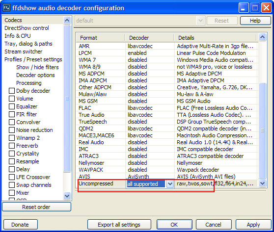

  6. I suspect it's the audio that's giving you issues
    If you are using ffdshow to decode, under the uncompressed setting, set "all supported" instead of "disabled" which is the default , and press apply. Close the media player , and restart it
    But if your AVI files that used to work suddenly don't, then that suggests a system wide issue (e.g. from a codec pack screwing up your system)
    Before going to reformat, try that codec tweak tool. If that doesn't work, try installing k-lite mega codec pack (perhaps something got screwed up in the uninstall)

    Thanks again for your suggestions. I had uninstalled ffdshow yesterday, but I reinstalled it just now and changed the uncompressed setting. Now my older vids (.avi) work again perfectly using WMP 11. The sound now works well with Quicktime also. The only issue is I get a twitch in the video every 3/4 of a second. It looks like a small jerking motion to the left and it does this throughout the entire video. I will try the codec tweak tool next.
