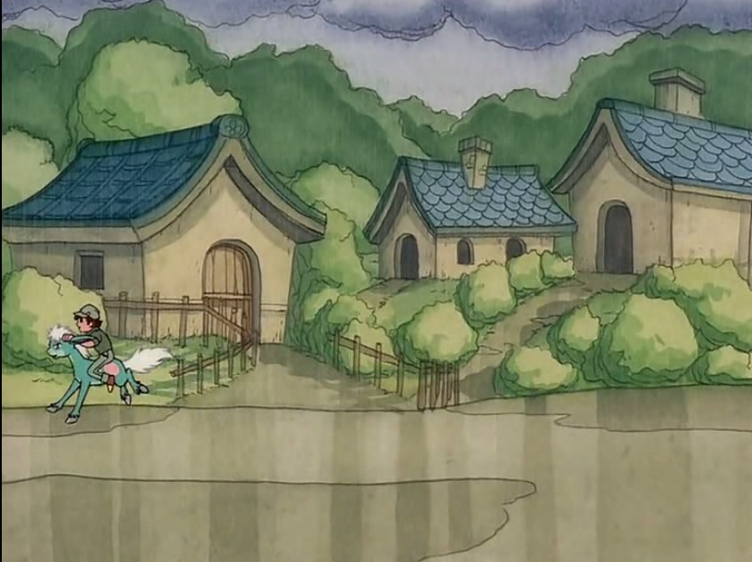

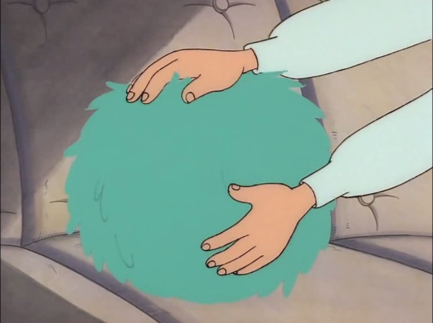

    Hello,

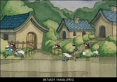

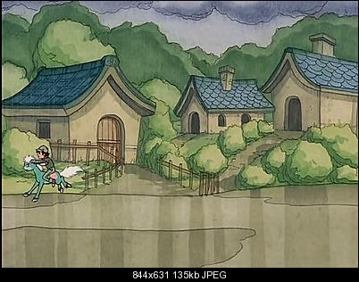

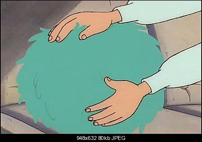

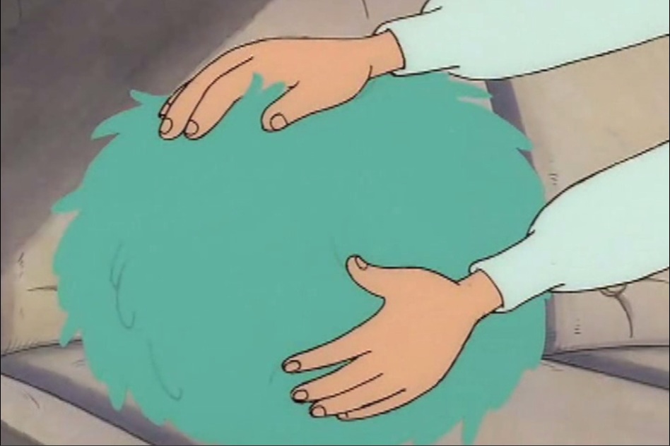

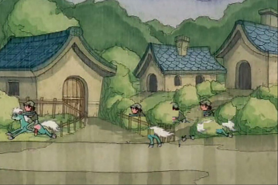

    I'm using Adobe Premiere Pro CS3 for Editing video to delete the sound and add a new sound to it but the problem is when i convert the movie to avi file the result video have medium Quality with file size 1.21GB and there is some noise on it not like the original video High Quality with file size 391MB and there is no noise. Why ? and How to fix this ?
    Look at the pictures:
    Original Video
ID:	179Click image for larger version
    Result Video
ID:	181Click image for larger version

  7. Your original was 768x576, square pixel , but you exported 720x480
    I suspect you used wrong sequence settings, like NTSC DV , and interlaced , then deinterlaced and resized upon export. This results in those aliased jaggy edges
    You need to use a custom progressive setting that matches your original in terms of dimensions, fps, progressive, PAR

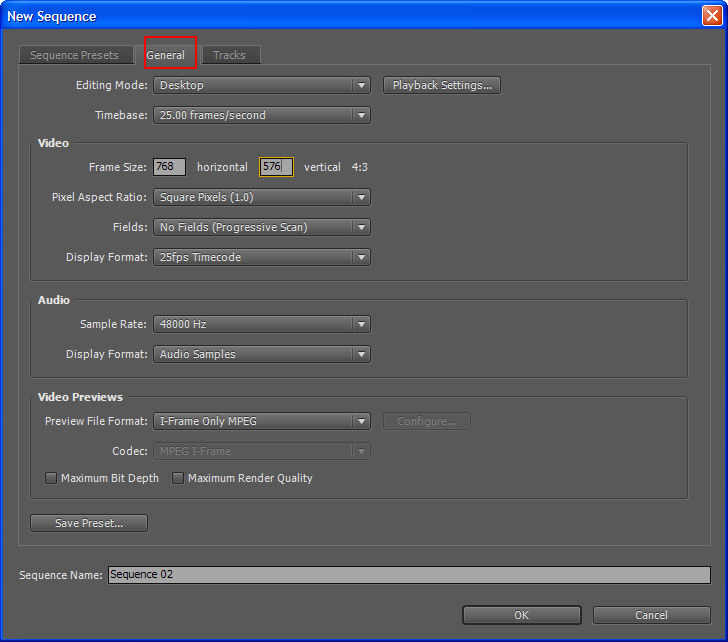

  9. start a new sequence , and enter the values that match your original (they are in the text file you uploaded)
    This screenshot is from CS4 , so it might look slightly different in CS3
    Then do your edits, and export using the same settings (frame size, PAR, fps etc....)
    Cheers
