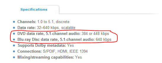

  8. Always Watching guns1inger's Avatar
    Apr 2004
    Miskatonic U
    The maximum allowable bitrate for AC3 audio for DVD compliance is 448 kbps. Some players will play discs with audio encoded at 640 kbps, but that does not make it compliant. 640 kbps is not DVD compliant. The attached image is taken from the official specs at Dolby.com.
    Don't confuse what your player can do with compliance
Name:	Dolby Specs.PNG

    this is the Dolby specifications but not the standalone player capacity.
    some older players(not all) have limitations about bitrate but not the news.
