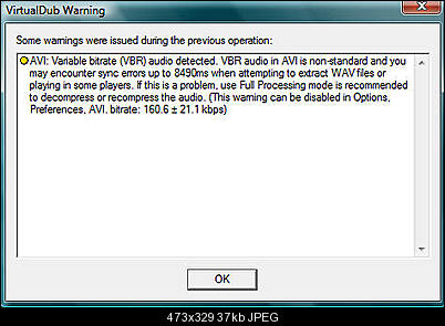

    ONe more thing, I do get this error when I first open a Divx video in VD.
    Is this error something to worry about, fix?
