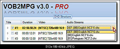

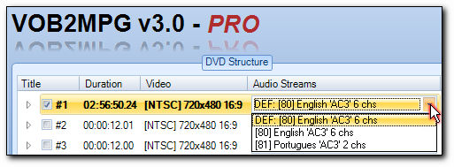

    Can you post a screenshot of the program with the DVD you are working on loaded? I am particually interested in the Audio Stream dropdown of Title you are trying to extract.... So something like:
