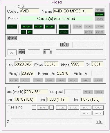

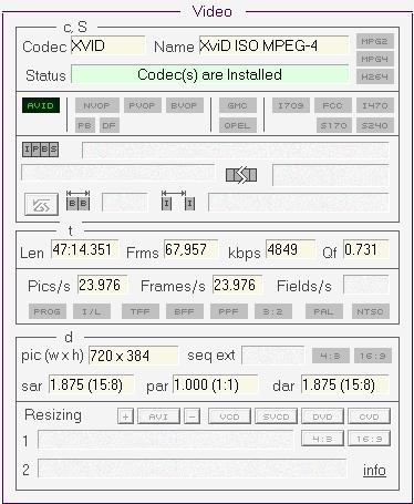

    I don't know what is the problem here but here's the GSpot video codec info for the both files if you need it to see it:
  3. How did you split your file?
    Nov 2005
    I used avidemux, split the two files at a non-keyframe and enabled smart copy when I saved the two files.
