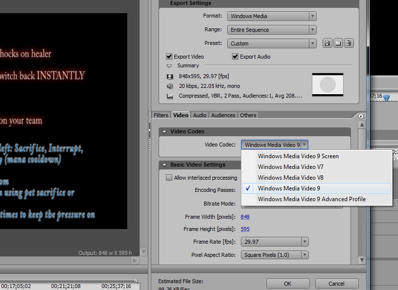

    so thanks to poisondeath I finally completed my video, but the site that wants me to upload it wants it to be in DivX format or something... I have detailed instructions for compressing the video using virtualdub, but I can't put my un-rendered clips into virtualdub, and I don't see DivX as an option in the adobe window (screenshot below)
    Any advice, as always, will be hugely appreciated

  2. install xvid , you specifically need the xvid vfw version for it to show up in premiere
    it will be under microsoft AVI
    your dimensions of 848x595 are very non standard and bizarre aspect ratio for square pixels; the dimensions should be evenly divisible by 16 ideally (or at least 8) - or it won't work
    another option: you could also use debugmode frameserver to frameserve out of premiere to use another encoding application

  7. It's not showing up in adobe however...possible to just use windows media video 9 or something?
  8. Set the format at the top to "microsoft avi" , not windows media
    If your submission guidelines allow WMV9, then go ahead
    If you want to use vdub, then use debugmode frameserver to export out of premiere , or encode to a lossless intermediate AVI (e.g. lagarith or huffyuv) first
  9. i don't see microsoft avi up there ><
    I have soooo many questions that I can't even remember them all. Let's say I go forward with WMV9, do i need to modify the aspect ratio? If so, what should I change it to? And the site wants videos compressed at maximum quality, so what settings will I need to go through and change to make sure it looks as good as can be? And would I have to add black bars now or after encoding? /boggle

  19. wait 1 more question. If I want to ensure high quality, would it be worth it for me to mess with any of these advanced settings, such as "Decoder complexity"? It defaults to auto but it could also be main complex or simple. And how about average video bitrate, it starts at 208 but i can slide it all the way up to 10000 if I want. will that improve the quality?
    And should I leave the keyframe interval at 5?
  20. higher bitrate means less lossy (= better quality) , but larger filesize since filesize = bitrate x running time
    use wvc1 (wmv9 advanced profile) for slightly better quality
    you can increase the keyframe interval (it will be more efficient compression, but seeking will be slower) , but I would just leave it
    you can encode a section to test first, if these settings are adequate for your goals, then proceed with the full project if they are, or re-adjust if they are not
