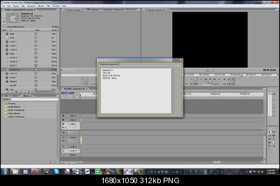

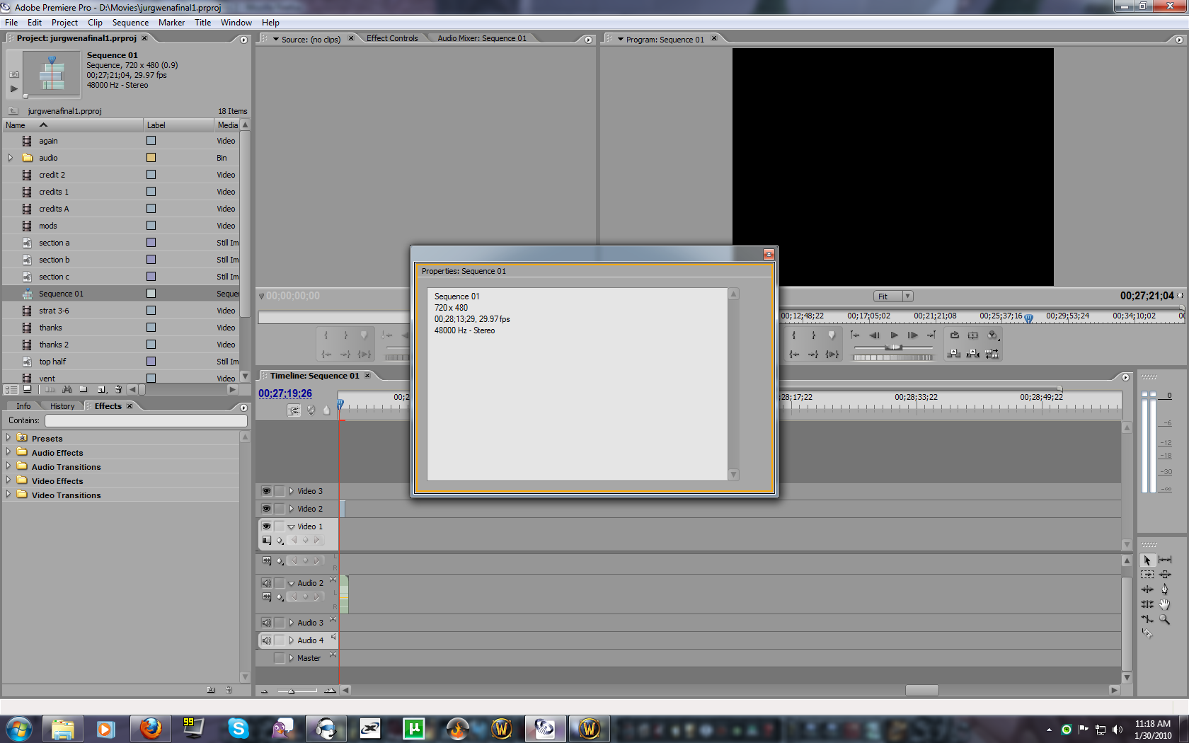

It must be a difference with our versions, because when i open a new sequence the only things I can change are the name of the sequence, the number of video tracks, and the type of audio (mono, stereo etc)
Can you post some screenshots of the sequence settings ?

like I said I did that, it doesn't allow me to modify anything except what i mentioned above
ok save your work first
open a new project , the 2nd tab will be "custom settings". (don't select anything from the 1st tab presets)
editing mode: select "desktop"
that should unlock the dimensions, fps etc.... -
