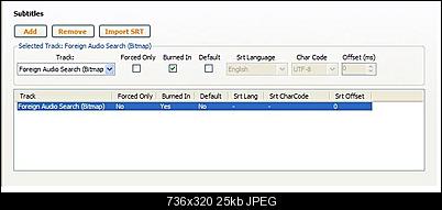

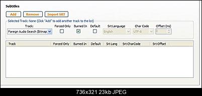

    Thanks for answer, but I can't load the ass subs. I start Handbrake, load the MKV set the dimensions, bitrate, etc.
    Then, I click on the Subtitles tab and click on add. However, it just adds some track to the list and doesn't ask me to add the subs. I can click on "Import SRT" but I need the subs in ASS format. If I were to convert it to SRT, it would lose its format.
    What am I doing wrong? It may have something to do with the "Track" input, but it cannot be changed to anything else. The only option I get is "Foreign Audio Search (Bitmap)"
    Here are pictures before and after I click on "Add":

    I missed that you wanted to keep your ass. . Then it wont work with handbrake.
    Try avidemux, under filters I think you can load ass subs and keep the ass features.
