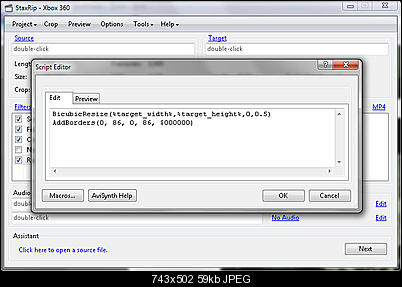

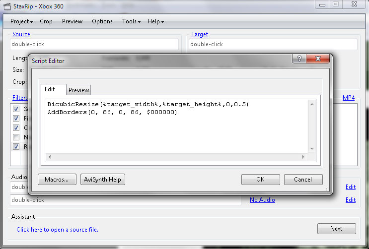

    It should be possible if you adjust the avisynth resize script. Double click on resize under filters and try add
    AddBorders(0, 86, 0, 86, $000000)
    86 is how many pixels and 000000 is the color(black).
