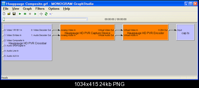

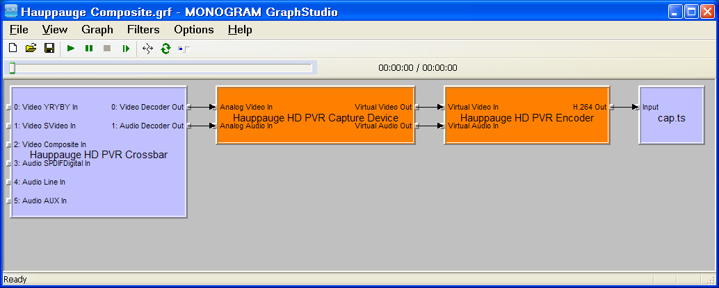

  3. Originally Posted by longaniza View Post
    Thanks. I'll see if I can use it, it seems a bit complicated. I think I have to create some graphical structure or something.
    Here's an example of a capture graph for the HD PVR:
    On the far right is the Dump filter -- it just takes whatever it gets and writes it to a file. Use Graph -> Add Filters to add each of those filters, configure the filters (right click and select Properties), attach the pins as indicated, and press the Play button. Once you have a working graph you can save it for easy access in the future.

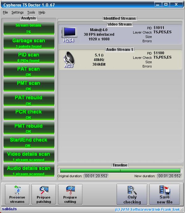

  10. Here some screen snapshots.
    I see everything fine.

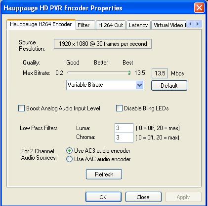

    Attached a file with all filters settings.
    Bit rate is set to 13500 constant.
    I see the video fine in the preview windows, so maybe the issue is in the PVR ENCODER filter.
    If I could replace this filter with an older one, I think this could be a nice test.
    The filter is ksproxy.ax, located in windows\system32.
    I could try one of those older one. What do you think?

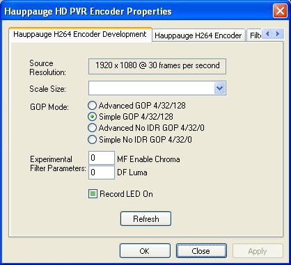

  23. I don't have several of those dialogs in my setup either. On the Virtual Video Out tab (one of the items I don't have) of the Capture Device dialog there are a few fields that say 720x480 instead of 1920x1080. That strikes me as a little odd since everywhere else it says the frame size is 1920x1080. Make sure the crossbar filter shows video is taken from the YRYBY input. That's about all I can think of.
    I have never used this stuff but I could offer a conjecture on this point. Could it possibly be showing this in a menu off the dvr? If you are doing this while in the menu of a dvr is that truly 1080i? Or is the menu actually 480?
    That might be the only thing throwing this off - unless the poster is switching back and forth to a standard defintion channel and not realizing it?
