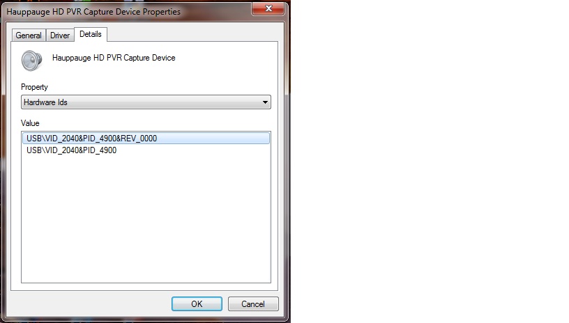

    I need to know the hardware VID/PID unit you have see below screenshot

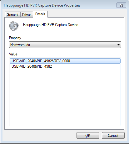

  18. Member
    Jan 2010
    ok i think this is what you wanted

  21. Member SHS's Avatar
    Oct 2000
    Vinita, Oklahoma
    mbrandt there was a small batch HD-PVR units that were intended for US, but end up being misprogrammed for Japan.
    You got a misprogrammed unit you should have it RMA through tech support.
    That why it not work rigth.
