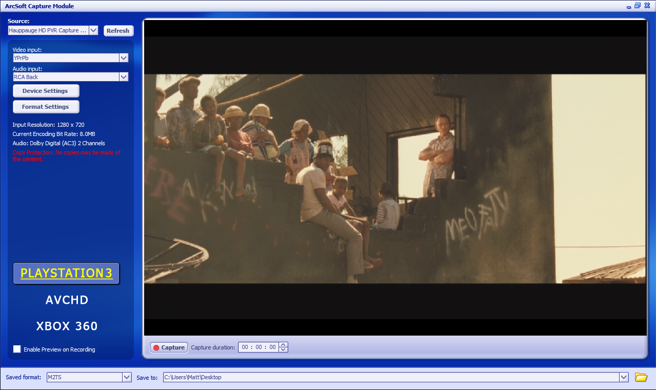

    I recently received my hd pvr and am able to record all my gameplay from my ps3 slim, but I am not able to record any of my blu rays to back them up. It says that there is copy protection and I can't record my blu rays. I thought that if I was recording from my component cables it would not be able to find the copy protection. Any help would be appreciated. This is the message that i am receiving.

    unfortunately i can't really revert back to anything because i basically installed the software that is came with. so there's really nothing for me to revert back to. do you think it's just the Total Media Extreme software or possibly the Ps3 or maybe even the actual HD Pvr? Do you think maybe a different hd pvr software (such as eyetv 3 for the mac) or maybe a different blu ray player could be the solution?

    yeah my only guess is that it is the slim ps3 that won't allow it. I know other people with the ps3 have done it, but that was with the older one. or it could be that sony patched this somehow in a firmware update.
  6. When the HD PVR first hit the streets it was confirmed that it ignored CGMS-A. That was one of its attractions. So this is a new developement. Either newer models or newer software now responds to the CGMS-A do-not-copy flag.

    ok so i tried installing the new programs and I am now running version 1.0.9.7 of Total Media Extreme and the Hauppauge HD-Pvr is using driver 1.5.6.0. However I still get the message that says copy protection: no copies may be made of this content. I was able to install TME with success but when I try to install the drivers it says "drivers have not been updated. Compatible hardware not found."
  16. Can you watch the incoming video but refuse to record it? Or does it not let you see the video at all?
    Jan 2010
    yes i can see the video but I can't record it. this is what the screen looks like

  20. Originally Posted by mbrandt View Post
    That means the HD PVR is getting the video, compressing it, sending to the PC, then the PC is decompressing the video, and displaying it. So the problem lies in the capture program, it's simply refusing to save the data it is receiving. You should be able to capture with GraphEdit or GraphStudio as I suggested earlier. That gives you a straight dump of the data from the driver to a file. You might also be able to use something like Sage TV or Beyond TV.

    yes i think it comes down to the hd-pvr because I just tried hooking it up to a sony bdp-bx2 and i still get the message.
  23. If TME can display the video that means it is getting into your computer. All you have to do is use capture software that doesn't refuse to save the data to a file.
