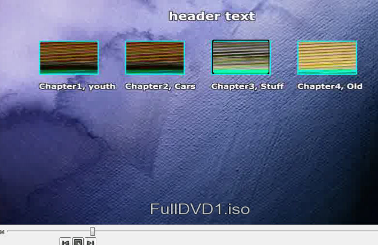

    I am working on making a motion menu using AVISynth and DVD author (also have FFMpeg and all the other good stuff). I'm able to pull the video clips I need over from my .mpg files but they won't display correctly. I've changed the box size to fit 720x480 and it still stays squished and looks the same. I've tired other encoders and still get the same issues. But if you click the chapter it does play the .mpg perfect, just can't view the video clips.
    In my log I see the lines
    NFO: Locale=C
    INFO: Converting filenames to US-ASCII
    STAT: 0:00:00.000
    INFO: PNG had 2 colors
    INFO: Constructing blank img
    INFO: Pickbuttongroups, success with 1 groups, useimg=1
    INFO: Found EOF in .sub file.
    INFO: Max_sub_size=1444
    WARN: Button y coordinates are odd for button 1: 84x98-184x169; they may not display properly.
    WARN: Button y coordinates are odd for button 2: 231x98-331x169; they may not display properly.
    WARN: Button y coordinates are odd for button 3: 381x98-481x169; they may not display properly.
    WARN: Button y coordinates are odd for button 4: 531x98-631x169; they may not display properly.
    WARN: Button y coordinates are odd for button 5: 295x41-465x61; they may not display properly.
    INFO: 1 subtitles added, 0 subtitles skipped, stream: 32, offset: 0.18
    But I can't figure out how to change these to fit properly.
    I've attached a screen shot of what I'm dealing with.
    Any help would be super great!

  2. All I see is a bunch of lines where the chapter videos are supposed to be. That usually indicates a wrong resolution. At what resolution did you make them? And do they play OK by themselves (before being added to the menu)? Also, maybe their location in the larger menu plays a role. It says the button coordinates are odd, and maybe that's because they all have at least one of the 2 coordinates on a odd numbered pixel.
  3. Hello,
    They play perfectly and the resoultion is 720x480 for the mpg videos. They play fine before and after I make them into a .iso.
    I'm using DVDauthor to call AVIsynth to make these, but I can't seem to find out where the scipt is that is making these files the wrong resoultion.
  4. Oh, so DVDAuthor takes them and adds them in automatically, resizing them and placing them in the correct location? Then I can't help. I don't use that program and when I do stuff like that I add in all the motion video myself to the menu backgrounds, make the M2Vs, and then feed the finished video into DVDAuthorGUI. But, if possible, I think you should try and shift the location of those 3 motion videos so the locations fall on even numbers.

  6. The M2V out of ffmpeg already has those 4 motion parts messed up? They're already messed up, right, and don't get messed up after being loaded into DVDAuthor? If so, try this. Those lines in the script that go:
    title1=mpegsource("C:\Users\cwebb\Desktop\bnandbn@ verizon.net\293249\footage\1.mpg").bilinearresize( 100, 66).addborders(2,2,2,2,bordercolor)
    Try changing the '66' to '68' and see if that makes any difference. There are 4 lines like that. I hope those video parts are progressive and not interlaced. Then reencode it and check if the outcome is any better. That'll mess up the outlines and button placement a bit . Maybe that'll be important to you or maybe it won't matter. But just run the test first. Shouldn't take long at all.
    By the way, the DVDAUthorGUI developer visits here sometimes. You might try renaming the thread to mention DVDAuthorGUI so it catches his eye if and when he checks in. This sounds to me like a bit of a bug in the program.

  8. well after playing around with this some more it seems like avisynth isn't resizing correctly with the mpg video. I tired to encode using Lanczosresize and BicubicResize but still had the same effects.
  9. They'll have to be deinterlaced prior to the resize. Otherwise, even if you can get them to display correctly (without those lines all through them), they'll still be a mess. You can't just resize interlaced material any old way, but only in an interlace-aware manner. The resizer used (Lanczos or Bilinear) isn't the cause, nor can switching from one to another change anything.

    I have actually seen that happen before with mpegsource (some type of bug in it on some systems). Try creating the d2v with dgindex, and use the mpeg2source input to open it (as apposed to the mpegsource). Dgindex is included in the bin folder, or you can download it from http://neuron2.net/dgmpgdec/dgmpgdec.html

    D2v are dgindex's project files. They are an indexed scan of your m2v. mpeg2source needs to open those files, instead of the m2v directly.
    I call dgindex in DVDAuthorGUI like so:
    DGIndex.exe -IF=[SOURCEFILE] -OM=0 -OF=[D2VFILE] -hide -exit
    Also, i modified DVDAuthorGUI to use either DGDecode, or directshowsource. This will bypass the need to use mpegsource, which as I mentioned previously, can be buggy sometimes.
    http://dl.dropbox.com/u/665345/DVDAuthorGUI_1.021.exe
    I'll keep that in my dropbox for a few days, before I move it to DVDAuthorGUI's download page, just to make sure there aren't any bugs.
    Edit: If you do choose DGIndex in the GUI, it will have to create the d2v files, which could take a while, depending on the m2v's size. I just reuploaded DVDAuthorGUI installer to fix a small bug related to that.
  19. WOOOOO HOOOOOO! SUCCESS!
    I used the updated AuthorGui and it works perfect! Thank you so much for your help Liquid!!! Is there anyway I can donate to you for all your help? Seriously, I've been at this for weeks trying to get the motion clips to work and couldn't of done it without your help.
