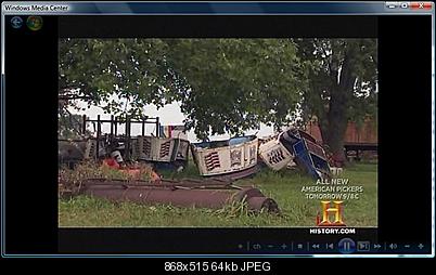

    A newb here just have a few question for ya, thanks to all in advance!
    PC is running Windows 7, 4GB Ram, Q6600 OC'd 3.0ghz, ATI 5770, 26" Dell 1080P Monitor connected via HDMI cable.
    I have a TV Tuner card installed. It was a Hauppauge branded Gateway card. I do not know the model number off hand, but i can get it if need be. My problem is my tv tuner quality is very very very grainy. Tuner card has 4 Outputs: CATV, NTSC, S Video & RCA. I do not have a digital cable box hooked up just coax that has been split to my room from outside. I can plug into CATV and i get picture, but it is grainy. I am guessing the reason i cannot get tv through NTSC is because no cable box? I have tried changing settings and software (Windows Media Center & PowerCinema 6) and the one thing that remains constant is tv quality. I would really like to get the picture better looking. Now my questions to you are:
    -Should i just splurge and get a new TV Tuner card?
    -Would a cable box make a difference?
    - Can I get better quality with some tweaks?
    -I know i lose resolution with cable input split, any way to improve?
    Thanks in advance and any help would be appreciated!
    -Sean

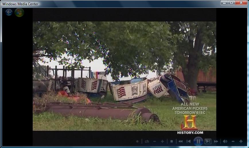

    There could be many issues, right off I'd blame your tv tuner card, I am not running off a cablebox in NTSC and mine workes really well. I had a USB hookup that has better quality than the above pic. This is how mine turns out using a coax
    There is a possibility that your coax is responsible.Click image for larger version

  3. That's an awful lot of noise -- not normal for a Hauppauge capture card. If you hook that cable coax to a TV is it noisy too? If so, a different capture card won't help.

    Sean are they on all channel like that screenshot?
    To me it look like the Tuner it self may be bad

    Yes all channels look like this. I am getting the feeling this will be the general consensus.

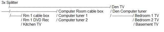

    You say the house is "wired for cable". Map the splitters between the incoming cable and every room outlet. Show us the cable map.
    If the house is properly wired, the cable tech is talking about adjusting the gain of the signal coming into the house. You can pay them extra to recable the house and check levels ane equalization at each outlet.
    For example, here is the approximate cable map for my house. There is considerable splitter gain loss to those bedroom TV outlets. It needs to be compensated at the cable company amplifier up on the telephone pole. If you can't get the cooperation of the cable company, you would replace the first splitter with an amplified model.

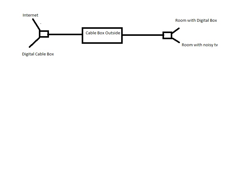

    Connected tv to coax and it produced the same results. Tested this before and after coax splitters outside of house with tube and lcd and both results were the same. I have not tested with cable box hooked up to tv tuner, this will be my project tonight. Diagram is: Cable box is mounted outside of house; It has coax going in both directions around the house. One goes to a splitter which then goes to main tv with digital box and cable modem. The other end goes to splitter, which then goes to seperate rooms, one of which has a digital box and the other does not (one with the issues.)
    Provider said 3rd room needs to be setup for digital cable, as that is why my reception is so bad. Cable card is 3 bucks a month, and they would install, but I am pretty sure I could do this myself.

  20. Here is an awful diagram.Click image for larger version

    So what quaity does a TV show at the noisy location?
    Does the "digital box" TV show good quaity on all channels?
    Sorry you answered that. The problem is with the cabling or splitter from that outside cable connection.
