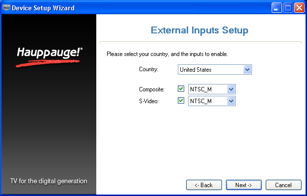

    pro/con: in order to get the composite and svideo features to show as a selection in wintv 7, you have to first include it during the channel scan. If you don't select these, it will never show up in the channel list and you will be pulling you hair our for nothing. This was my other eye opener to how stupid a design this is. I ran around in circles before I finally figured this out.

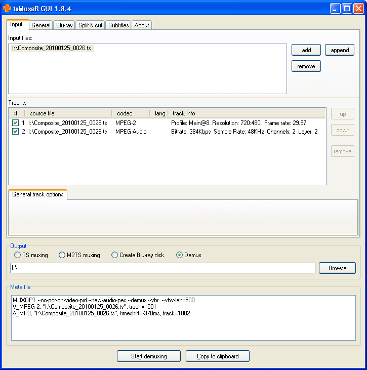

    pro: demuxing .ts files--I found the tool that works, tsMuxeR GUI 1.8.4 does the trick. After dragging your .ts file into the gui, just select the (o) demux option and click the [start demuxing] button. The demuxed file ends up as an .mpv file. At this time, I am not certain whether [x] auto convert MPEG-2 to .mpg option re-converts the video or just puts a/v into a new container.

    Put it to you this way, if you don't see these two dialog settings when you first setup for the channel scan, then you are in trouble.
    [img]vhelp_hvr2250_chan_setup_screen1.png[/img]
    [img]vhelp_hvr2250_chan_setup_screen2.png[/img]

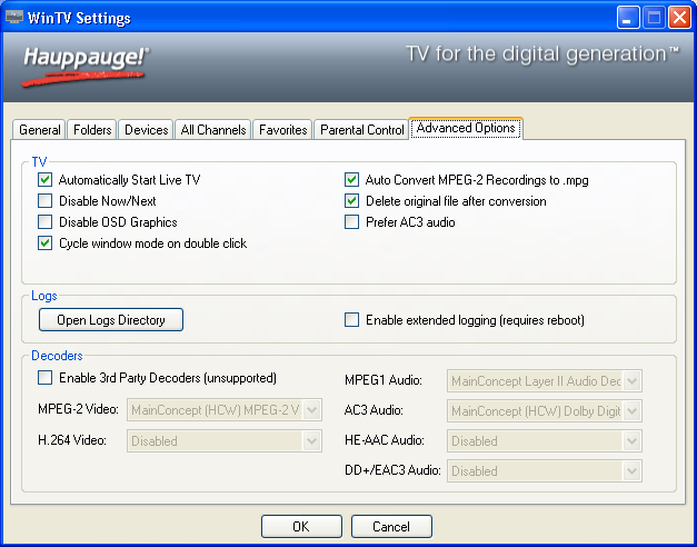

    So, it looks like the whole problem was with the wintv 7 software, the original version on the cd is a bad build and is very bare-bones in settings, (the 1.2c has more features/settings) and you are better off downloading that as soon as you get the hvr-2250 home, and avoid the madness I went through.

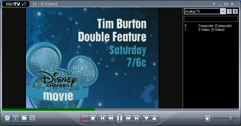

    Here's example of composite recordings.
    [img]vhelp_hvr2250_laserdisc_example.png[/img]
    Here's example of s-video records.
    [img]vhelp_hvr2250_directv_example.png[/img]
    And, here is the tsMuxeR GUI 1.8.4 in action with the hvr-2250 recorded .ts file.
    [img]vhelp_hvr2250_txmuxer_example.png[/img]

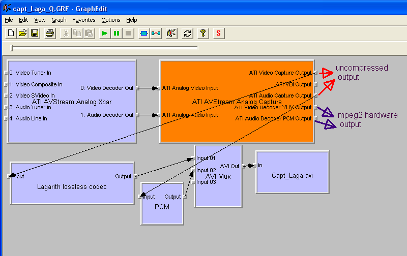

    May 2007
    Romania
    You may try VirtualDub or graphedit for uncompressed video. ATI Theatre 550/650 also is a hardware mpeg engine but it has two different output, one uncompressed and one mpeg2 compressed. With original software only compressed output is available. With others software (VirtualDub and grapgedit) is possible get access to uncompressed pinout.
    You should try to see if is true the trick.

    As for advanced video option I have been asking them about that in wintv 7 as well min of old option from wintv 2000/6.
    2250 can do things that none of other hauppauge card do rec 16:9 mode but you have used graphedit.

    Hi guys. Thanks SHS. Today I am even happier than yesterday
    Thanks danno78 for the graphedit suggestion, however, I just found out that I don't need it!
    As it turns out, the HVR-2250 does support raw avi captures, tested under virtualdub, works great, I love it! I used a commercial vhs tape and I did examine it (magnified it) and found no hardwared encoded mpeg macroblocks (or pixelation) anywhere, no evidense of real-time transcode of any sort.
    So, it looks like this card has an undocumented feature, at very least is not stated anywhere on the websites I've researched about the card. They all say something similar: hardware encoder, hardware encoder. But no where do you see, also uncompressed avi.
