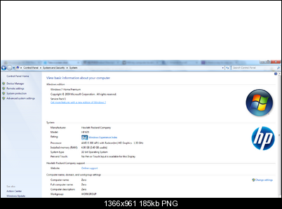

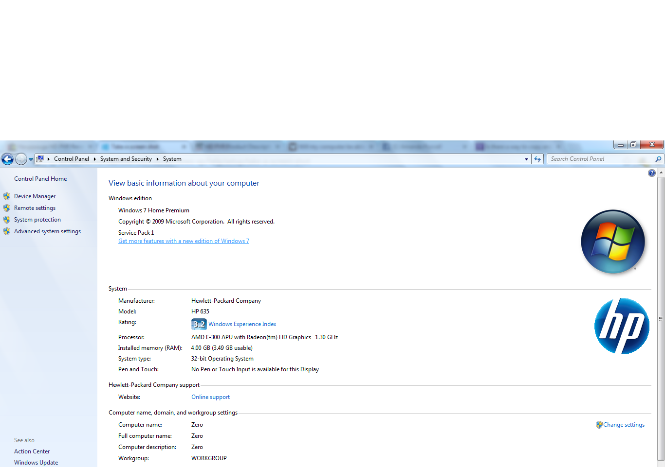

  14. Im thinking of getting an HD PVR to record game play and i just wanna know would my laptop handle it my friend says my ghz is to low and i just dont wanna spend money i really dont have for something i cant use
Name:	system specs.png
  15. Should be ok for basic capture.
  16. Banned
    Freedonia
    The HD PVR uses a chip internal to the device to do the encoding so this means that your laptop just has to be powerful enough to playback what it encodes, not powerful enough to do the encoding itself. Your laptop is fine.
