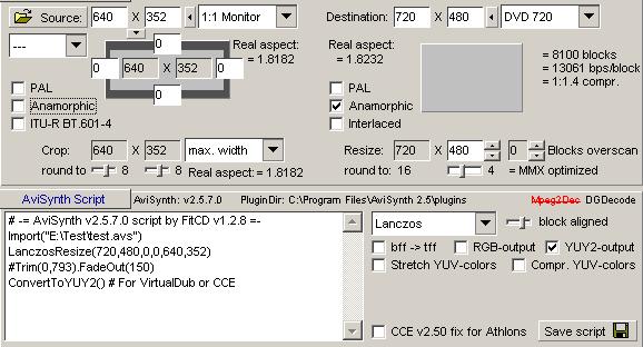

  8. Use FitCD to get the correct Crop/Resize/AddBorders commands. In your case, if intending to encode as NTSC 16:9, a straight resize to 720x480 is good:
    Lanczos4Resize(720,480)

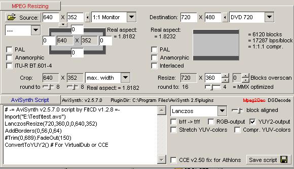

  15. I already gave you the 2 scripts, one for 16:9 encoding and the other for 4:3 encoding in CCE. Don't ever use odd numbers for the crops, resizes, or addborders when the source is YV12. Use BicubicResize if you like. Here's the FitCD pic for 4:3 encoding of your 640x352 source AVI:
