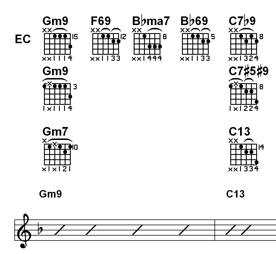

Hi Scott,
Thank you for your reply. A few notes about this situation. The music program the artist used to created these charts only has the option to export as a high resolution or low resolution PNG file. So I exported it as high res. and opened it in photoshop to make sure it layed properly into a 7.5x10" document at 300DPI. This will allow me to have a half inch margin all the way around. That's all fine and good. I saved them as PNG files from photoshop (greyscale). I was going to go to PDF directly from photoshop but something is wrong there and it keeps giving me a blank PDF. But I can do it from Fireworks. So with all that in mind, I really am just trying to figure out all the various options with downsampling, JPEG vs ZIP compression.. I could probably just select the "high quality print" preset and be fine, but this is just me wanting to know what everything means
Oh, and the printer already told me that they just need an 8.5x11 PDF file and they will do all the imposition stuff..
The sample is a cutout section from the actual PNG file, at the actual high resolution. -
It could very well be that the PNG export function in Photoshop doesn't support greyscale colorspace. If so, you could convert it back to RGB (it's still a good idea to lose the chroma first) and try exporting again.
If you can do it from Fireworks, that's ok too, though I don't remember if it has as many export options as Photoshop does. I'd recommend you still use ZIP compression rather than JPG compression. You won't get that "blockiness", nor any excessive banding (more than you'd get from the usual 8bit gradations). What other preset options do you want to know?
I understand the clip you supplied is 300dpi, but at that resolution, that section is only 3.2x2.94 inches. So, assuming it's only say- a quarter of the image, when shown on a page at 300dpi it is going to have the effect the individual graphic elements pretty small. When they're small, you want all the fine lines to be seen, which is why I hoped the printshop would be using 600 or more dpi for that extra clarity. 300 it is then, no matter.
