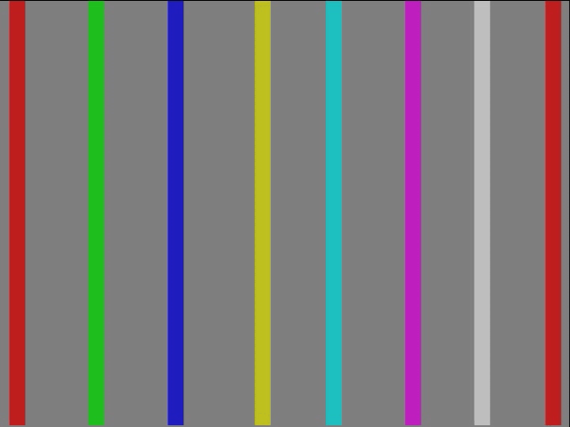

Now try it with a medium speed, sharp, panning shot. Most frames will look like double exposures.Originally Posted by MJ Peg
Yes. Although, with 25 -> 30 at least one frame out of every 6 will be a single exposure. With 25 -> 29.97 virtually all frames will be double exposures.Originally Posted by MJ Peg -
If my table above is correct, then 2 out of every 6 frames will be unaffected, but that transition from blur to no blur will be happening 5 times a second - so I'm expecting a flicker of some sort. -
^ooooh psychadelic jagabo!

Thanks, I've just tried a clip with a ceiling fan slowing to a stop, in a bright conservatory. The digicam had to use a short exposure time which doesn't make for attractive video, but is just the trick for this test as the fan blades are quite distinct in each frame.
As you have demonstrated, there is one clear frame every 6, with the 5 frames in between featuring leading or trailing ghosting. The middle one of each of the blended 5 is equally blended 50/50.
Anything stationary looks fine, and I can't quite make my mind up whether I can put up with the motion ghosting or not. It is an extreme case which didn't look great as it was at the original frame rate anyway, so I'd need to run some more tests on normal footage. I suspect that if the original footage is watchable (not too much panning about or zooming, but steady shots containing movement with a reasonable exposure time) then the converted footage wouldn't be too bad.
