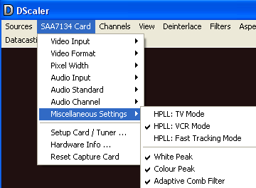

    Buy a cheap card based on SAA7131, SAA7134, or SAA7135 cipset and use DScaler with these settings:
    Image Attached Images
