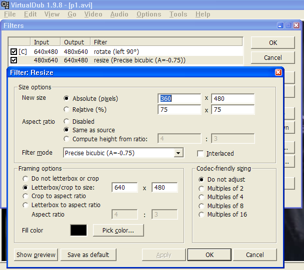

  5. You can just work in sections in VirtualDub then append all the sections together later. As indicated though, you'll have to crop/resize after rotating to keep the same frame dimensions.
    A short sample with middle shot rotated and resized:
    rot.avi
    Jan 2010
    Jagabo, your example vid is exactly what Im trying to do. I wasn't doing the resize after the rotate so I think that will probably solve my problems with Virtualdub if I add the resize after. Im still getting used to how Virtualdub works! But thanks a lot for your help.
