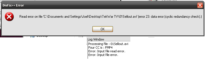

Ok just tried both DivFixPP and DivXRepair and no go here is what divfixpp said to me, I'm attaching both pics. So it seems to be a crc problem, any ideas?
Ok fixed it, sort of ha ha. For those in the future who want to know. VirtualDub, find the parts that freeze and just remove then resave. The good thing is that vdub though it will look like its freezing it, give it a bit it will come back and you can then select the area you want to erase from the file. VDub works like a charm. Thanks for the help.
