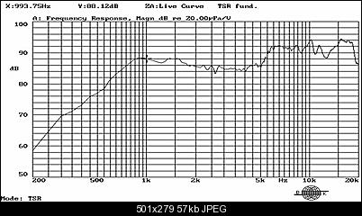

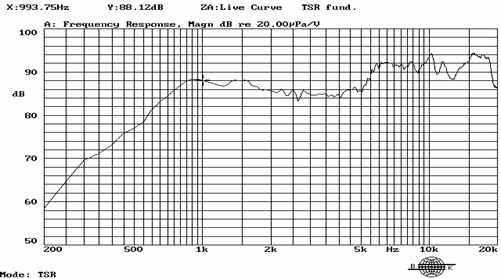

    here is just frequency response curve of my phone speaker, is it Ok to set High Pass Filter value 160Hz? Or more?
  16. Did you compensate for the frequency response of your microphone? If not the plot is pretty meaningless.
    Why would you need a high pass filter with a cutoff at 160 Hz? The sample contains virtually nothing down there.
    Aug 2006
    Earth
    this graph is from manufacturer's specs of speaker, not mine. I just want supress lower frequences, as mobile speakers can't reproduce very low frequencies, and may even be damaged.
