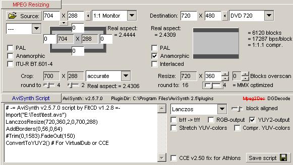

    When encoding, when does it really matter to set HCenc to 16:9 or 4:3?
    Yes, a lot. That script is for a 4:3 DVD. If you encode it as 16:9 the resulting aspect ratio will be badly messed up. And I wouldn't use that script even if I were encoding for 4:3. You've allowed for 2 blocks overscan (which is default, for some reason) which I don't do. If encoding for 16:9 I'd do it like this, which is a variation of the script FitCD gives for 16:9 encoding and no addition of overscan bars:
    LanczosResize(720,360)
    AddBorders(0,60,0,60)

    AlanHK sticks with the defaults in his XLogo guide,
    Yeah, and there's more that can be done to improve things. Not that AlanHK wouldn't approve of further tweaking the settings. His guide is a basic getting-started-with-XLogo type guide. But since I've never used the MSU one, I can't make any suggestions to make XLogo more like the MSU one.
    If you're going to be playing around with a lot of these caps, and if they often have logos, then it's in your best interests to learn about the different methods to remove the logos, and which work best under which circumstances. Then pretty soon we'll all be learning from a guide you write.
