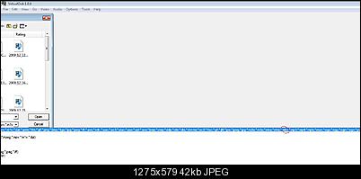

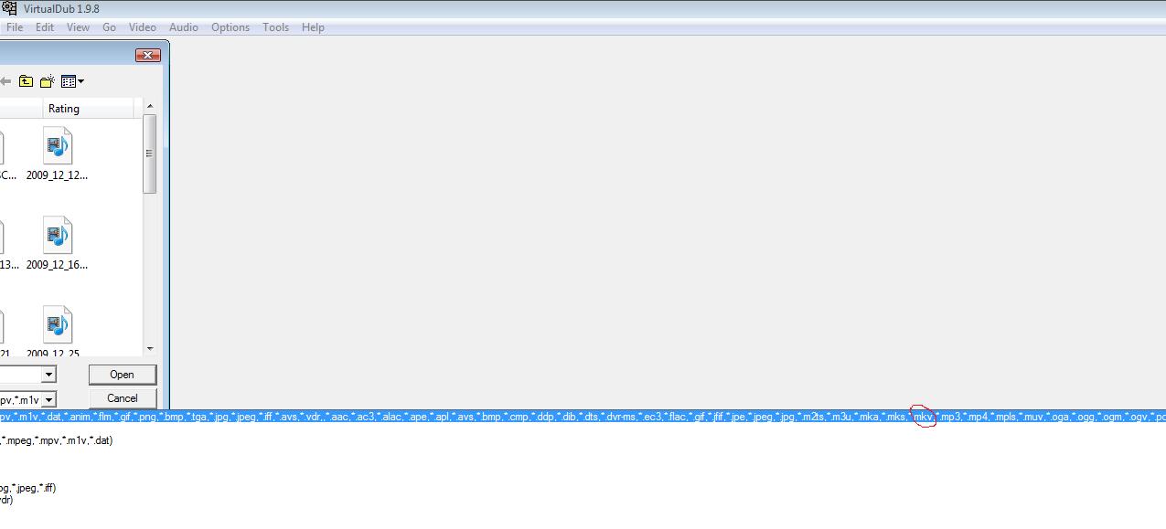

    Actually, I directly import mkv files into virtualdub all the time.
    Just to show you:
    Unfortunately I can't really remember how I got to this point. I believe I installed something and all of sudden I could start importing mkv, ts, etc. files directly.
