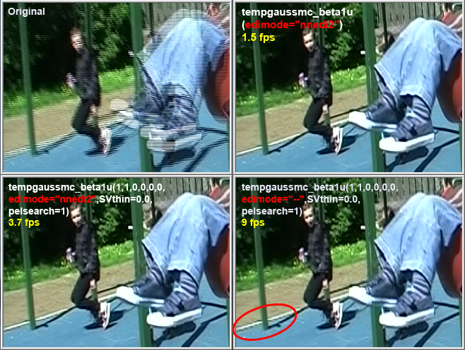

    There's talk of some command line parameters that will speed it up. At the cost of slightly lesser quality.
    https://forum.videohelp.com/threads/319816-Improving-old-VHS-What-to-expect?p=1981816&v...=1#post1981816
    I found it to be roughly 5x faster.
    Thanks for this link, jagabo.
    I tried out the code:
    tempgaussmc_beta1u(1,1,0,0,0,0,edimode="--",SVthin=0.0,pelsearch=1)
    However, I found the same problem getting jaggy diagonal lines that I mention in this post: https://forum.videohelp.com/threads/315725-TempGaussMC-showing-jaggy-diagonal-lines. If I changed the edimode to nnedi2, the problem went away - although at the cost of speed:
    So these 'fast settings' with NNEDI2 still give me a 2.5x speed improvement over the 'default' settings (3.7 fps vs 1.5 fps) with the quality I'm looking for. Thanks!
