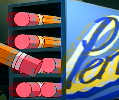

  6. VirtualDub's interlaced chroma problem doesn't effect the brightness of the picture. It causes mixing of the colors between the two fields. For example this (after deinterlacing):
    instead of this:
    Brightness issues between VirtualDub and AviSynth are most likely just a matter of how you're viewing the the two methods (media players usually use video overlay which has its own brightness, contrast, and color settings, editors usually use Windows GDI) or possibly the YUV to RGB conversion matrix used.

    The first pic you posted is the problem I having when deinterlacing in virtualdub.
