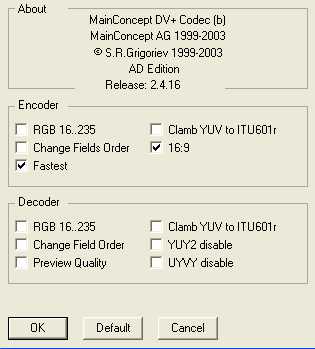

On that Vdub filter chain, how are you doing it? Are you leaving all filters active during the initial pass with the Deshaker or turning them off on first pass? Are you hitting the output button or using the "run analysis pass" command?
You say you used the "default" DeShaker settings, but that specifies square pixels, progressive scan and the wrong dimension for DV avi. Can you clarify?

What DV decoder are you using? I wonder if it might be putting out YV12 which VirtualDub will screw up. Try forcing VirtualDub's to use its internal DV decoder.

Since "YUY2 disable" isn't checked you're probably getting YUY2 in VirtualDub. Unfortunately, VirtualDub doesn't seem to report the colorspace it negotiated with the DV decoder. But try using VirtualDub's internal DV decoder anyway:
Options -> Preferences -> AVI -> Prefer Internal Video Decoders... -

When I was examining your samples earlier I was looking only at BOB'd output on the screen. But I zoomed into the actual source and see a worse problem. Your deshaken output has corrupted the two fields. There are no longer distinct comb artifacts everywhere where they should be. Here's a 2x zoom from your deshaken (left) output vs mine (right):
Mine looks like the source. Yours had corrupted the two fields. Did you do some other filtering? -
I couldn't reproduce your issues with the same filters, but I'm using a different DV decoder and encoder, cedocida.
If you export a lossless format, like huffyuv or lagarith, do you see the corruption? If not, then it suggests the encoder is at fault. If it still is corrupted, then it suggests the decoder or your filters are at fault
Your mainconcept dialog box is old, you might be using an outdated version, it might be corrupting your video somewhere along the line (either decode or encode). I have a newer mainconcept DV encoder (directshow, not vfw) , and it worked normally as well on a lossless export from vdub

I also notice that media info isn't reporting the Mainconcept DV codec anywhere on my DV files, it's saying Sony. -
Looking at the Mainconcept site, I don't see a newer version of the DV codec than the 2.4.16 than I'm using. Where do you find yours?Originally Posted by poisondeathray

MediaInfo always reports Sony DV when the fourcc is "DVSD". It doesn't matter what DV decoder you're using.Originally Posted by brassplyer -
It's not a vfw codec (doesn't work with vdub) , it came with my DVCPRO HD pack. v7.something. I just checked the site, and I guess yours is the most recent version for standard DV. Before, I just quickly looked at the dates, yours said 2003, mine said 2008Originally Posted by brassplyer
