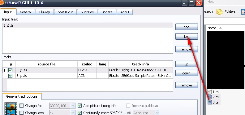

    Check it out. You have to add the first one by itself, then multiple choose the additional ones and drag them onto the join button
    Thanks, I didn't know that.
