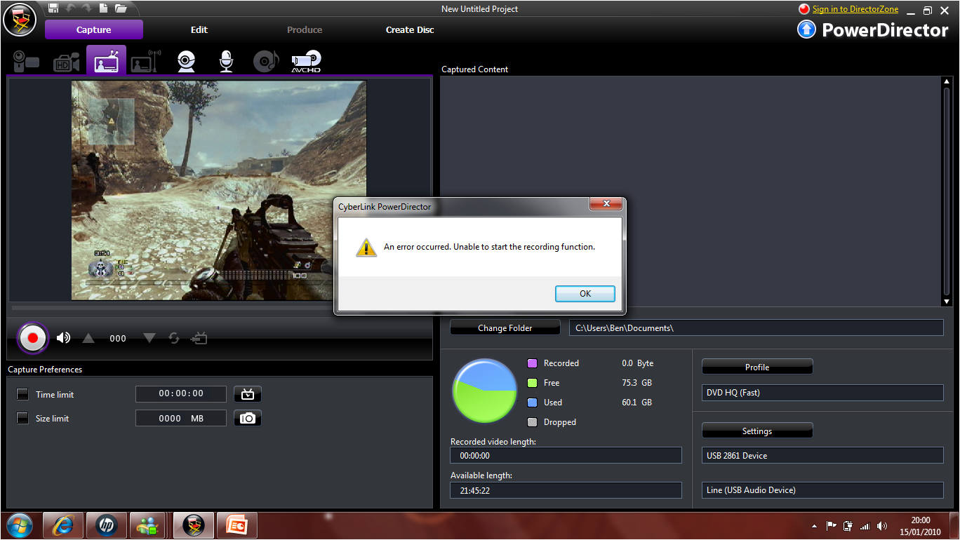

    this is me setting up as mpeg
    Jan 2010
    then i click record then this happens
  22. aBigMeanie aedipuss's Avatar
    Oct 2005
    666th portal
    click the settings button above the usb recording device and see if it's set up correctly.

  24. Member
    Jan 2010
    well what settings would be 'Correct'

  26. aBigMeanie aedipuss's Avatar
    Oct 2005
    666th portal
    first i'd re-install the driver. somehow i think it isn't identifying the device properly. it should say what kworld product it is not generic usb device.
    then it's hard to know what settings would be ok without seeing them. maybe a screenshot?
