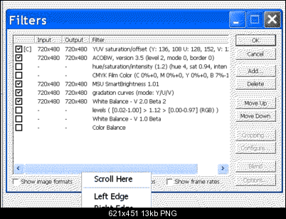

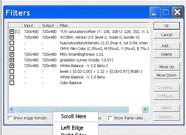

  18. By know there are new programs that deal with low lighting, but here 1of 8 filter combos within virtualdub [this combo not the best of the bunch but uses the most available filters]
    here the "The Good Ship Kangaroo" by Ronan Quinn wMatt Glover at Precinct 11110 sen t through the filter combo VIDEO IS UNLISTED:http://www.youtube.com/watch?v=5rc8qMVRUEg
    THE BEGINNING of the video show comparison stills and filters used but the latter in resizing ruined it clarity here the filters in this 'png' capture:Click image for larger version
