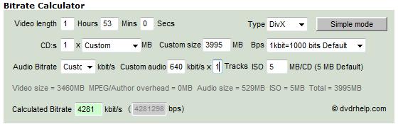

I chose a target size of 3995MB total, probably a bit too large to end up under 4GB, but it should be close. From a bitrate calculator:
You could see that the video bitrate would need to be about 4280Kbps for this example, down from 4761Kbps. But reducing the framesize to 1280 X 720 would give you the best use of that available 4280Kbps video bitrate. The video file would then be about 3.46GBs.

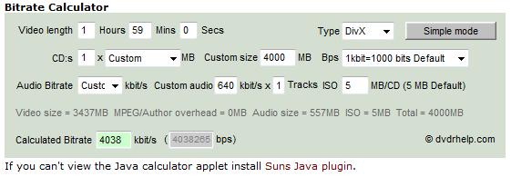

Redwudz- how are you getting the total file size for the video? I cannot find out ho you are coming up with the 3995 value for me. I'm wanting to do a movie that is 1hr 59 minutes and 05 seconds long at either exactly 4gb or around 4gb (like 3.99 or similar). and I have a 640kbps ac3 audio that is 545mb in size. Please help, thanks -
I just input the running time of my video and threw in a custom output size and the calculator came up with the bitrate. I could have used 4GB, but I opted for a slightly smaller file size to allow for errors. Even that may be too big, it depends on how accurate the encodes are. Bitrate can be somewhat variable for a certain output quality. A video with a lot of high speed action like a Kung Fu movie needs a lot of bitrate to keep from artifacting and blurring in fast action. A TV interview can use a low bitrate and still look good. Either way, more video bitrate is usually better. If your audio bitrate is fixed, then all you can do is adjust the video bitrate.
Try a calculator with the info from one of your processed videos and see how close it comes to what you have. Usually it's fairly close on guessing the file sizes and bitrates. In my example, it's mostly a demonstration of what you might need to do to reduce file size and help to understand the relationships between running times, bitrates and file sizes.
From your data:
I don't know if I mentioned it, but I used the VideoHelp Bitrate calculator. -
