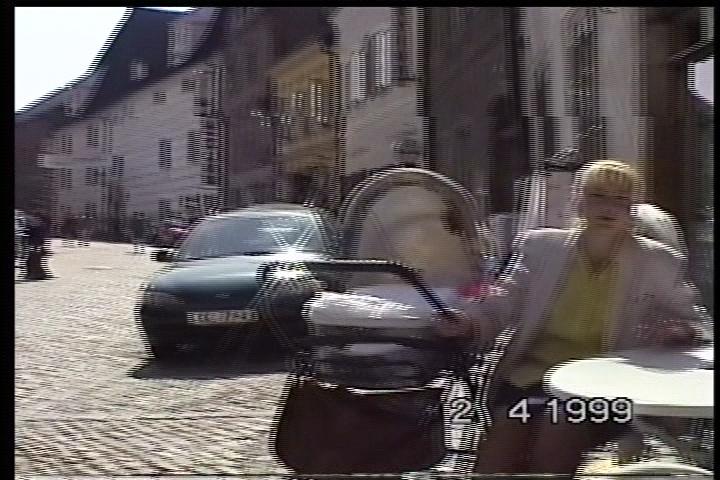

  24. Visited the shop that did the conversions today and playback from my tapes appeared no different than the DVDs they had made for me. Their conversion was from a Sony PAL Camcorder straight through a blackbox converter directly to the DVD. I suppose a DV-avi would have been better if analyzed, but on screen I saw the same artifacts directly from the camcorder. Anyway I'm not going to spend more money for that conversion unless I come across a PAL camcorder to buy or borrow.
    Brings me back then, the buzz does not appear to have come from the conversion but is an artifact on the tapes (at least to my eye and that of the technician who viewed it). Is there any filtering that can soften the whole thing?
  25. Originally Posted by BwanaP
    Did you really see the PAL video on a PAL TV? Or only through the converter box? I find it hard to believe that any camcorder could produce such artifacts.

    Actually, the buzz is not as bad as I remembered it. The tearing is a problem though. About every 6th frame has a tear:
    Bobbed and cropped:
    The only way I see of fixing this is to go through the video frame by frame and cut/paste.
  28. Yes PAL camcorder directly to a multi system TV.
    So that tear has to be from the conversion then? I mean the camcorder would not have recorded like that.
