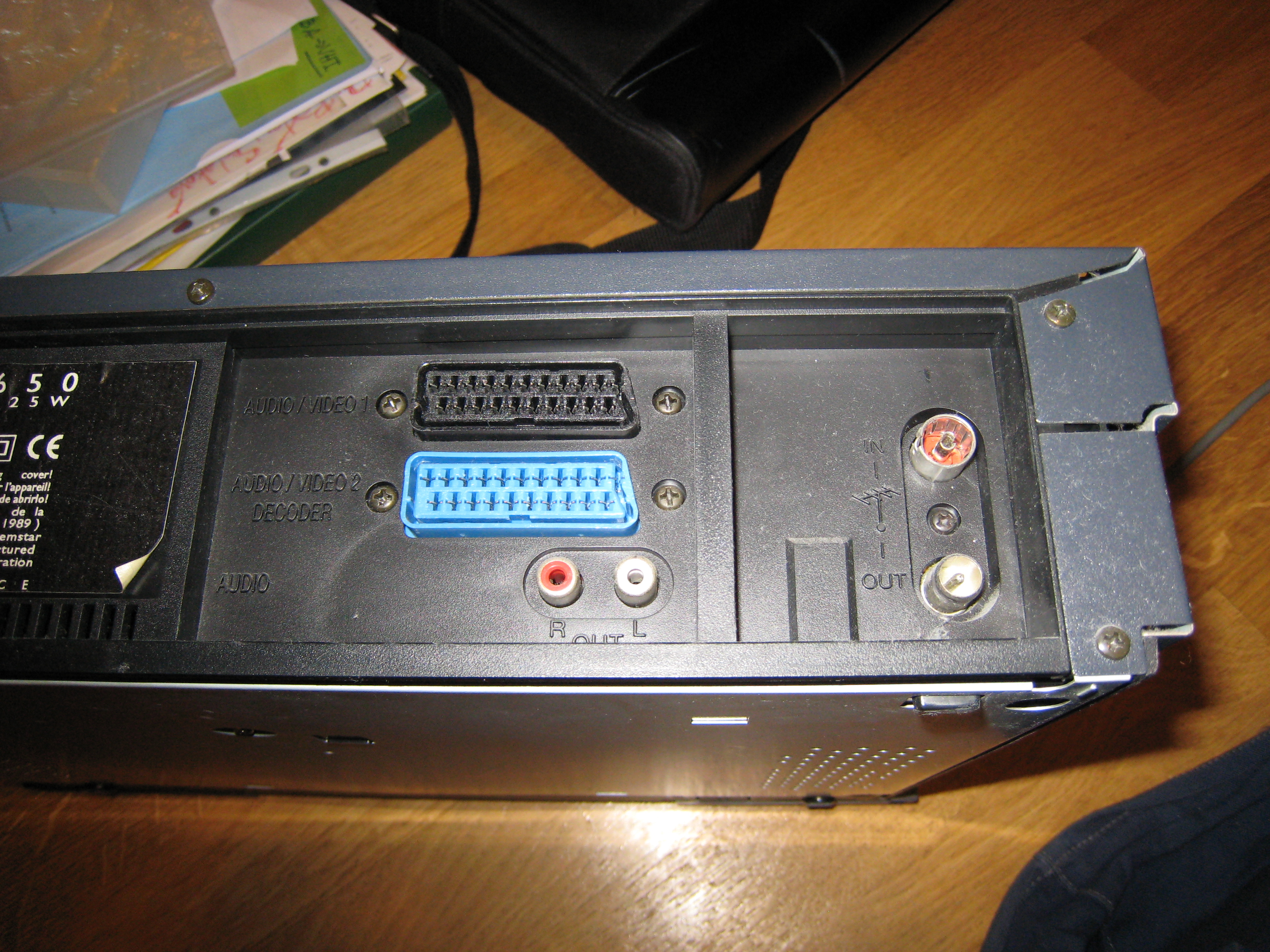

I bought the VHS To DVD 4.0 Deluxe (http://www.amazon.com/dp/B001VPGBCO/ref=asc_df_B001VPGBCO994674?smid=ATVPDKIKX0DER&tag...SIN=B001VPGBCO)
It says that to make it work, I need RCA Plugs for composite video (yellow) and stereo audio (white and red) to go into my VCR. My VCR doesn't have (as far as I know) these plugs. There is a red and white one, but no yellow.
It is a French VCR, I would have thought they are the same, but I guess not?
The brand of VCR is Thomson VPH6650.
I have attached a picture. What cable can I use to connect this converter to my VHS?
you can probably find scart to composite locally. something like this.

Buy a SCART OUT to RCA cable. Some of those cables are directional....that is why I said OUT - SCART OUT(from the VCR).
SCART to composite adapter.

France uses a special SECAM for video format, too.Want my help? Ask here! (not via PM!)
