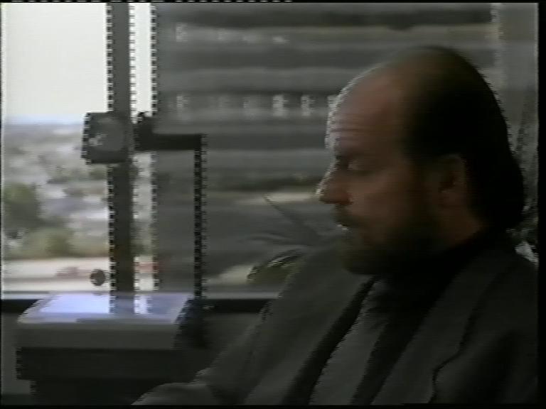

I obtained via Ebay a quite rare VHS err um so rare that this guy seems now to have plenty of copies.![]()
The tape comes in a proper card type case which is par for a US recording, perfectly printed with all logos etc (Columbia Tristar )- not the plastic type cases with inserts we get over here in the UK and was preported to be NTSC.
However the tape plays like a PAL tape (the other NTSC ones I have would stall in my capture unit unless I change the settings)
But playback is by no means smooth. There is consiberable 'combing'. The impression I now get is that it is a not-so-clever 'fake' made from a dvd. But someone has certainly gone to a lot of trouble with the packaging.
I have triied various capture settings - reversing the field order, delinterlacing etc but none will remove the 'combing'.
Anyone have any thoughts on this. And before you say it, this particular film is not officially available on dvd.

Despite what it says on the tin, this VHS is most definately a PAL copy. What puzzles me is how the people who did this managed to create what appear to be interlacing artifacts into the video.
Had a spare hour or so tonight so I did a straight VHS >> DVD dub with my dvd-recorder. Don't think that would have worked if it had been an NTSC tape and, naturally, the 'combing' is still there. I am going to do some filtering on the various captures that I played with earlier and even on this later dub just to see if there is a solution.

My theory is that someone made a poor dvd version of this with interlacing artifacts (There is no noise on the bottom of the screen as you normally get with VHS). Those artifacts were then hard-coded into the VHS copies. Like I said, the box says NTSC, the video is PAL. An official PAL video (for the UK) would certainly have a BBFC certificate for 1994.
The net resuslt - and I have since tried all sorts of deintetlace options and IVTC - is that the capture retains the artifacts and nothing can be salvaged from it. -

I'm no expert, but based on what I observed in the image you posted above, its possible that you have a copy of a poor ntsc_vhs -> pal_vhs conversion. Someone applied the (NTSC->PAL) *resize* of the frames at the wrong stage in the conversion process, maybe before or after the framerate step, or maybe its a combination of multiple issues, all done wrong or bad (and yet to be discovered--you only posted on image, one issue) so far. And, worse, they did not even review the finished conversion at any stage, and re-transfered it to vhs.
The way I determined this:
When I split that image into fields, I could see there were two distinct images: one was jagged and the other was clean but shifted to the left (or right) depending on how you observe it.
Also, there is noticable macroblocks (Pixelation) in that image you posted above. This could be from your dvd record (your vcr->dvd_recorder) no doubt. But to minimize any room for possible problems in these kinds of conversions it is always best to use the analog capture card route.
However, if this is a consumer-scam copy (as seemingly evidenced) you can probably discern this by properly re-capturing the tape using an analog capture card and capturing uncompressed.
Then:
A) If you don't see any macroblocks then something else is causing those issues you see, and the copy is legit. But I doubt this on account of your example image.
B) If you do still see macroblocks in the uncompressed source then you have a scam copy, and a bad one at that, and as has been told in countless other thread topics, this is not something you can correct.
Still, in either case, you should always use the analog capture card, to uncompressed avi.
EDIT: something else I just noticed in that image (I only quickly glanced at it earlier) that image seems to be part of a "blended" frame. When you look at Michael Ironside's head, you see part of it moving (leftward) while the other part (rightward) is still. I don't think this is related to any temporal noise reduction process. So, that frame was probably part of a blended operation, framerate related.

Yep. I've seen that before on some home movie footage that had gone NTSC>PAL.Originally Posted by vhelp
I reckon there must be a cheap standards conversion box or VCR that does exactly what you see here - a dumb frame resize without proper regard for the interlacing. Or maybe you have to chain two specific pieces of equipment together to get this "unique" effect! Or maybe something somewhere does this when you try to capture NTSC as PAL.
It'll be a challenge to undo it. You'd need to post a clip, not just a still image. If there's a repeating pattern of good/bad fields, maybe some appropriate selectevery() commands in AVIsynth can give something usable?

As requested I have now upped an approx one-minute sample of the video - same sequence from the still.
http://rapidshare.com/files/333695736/save_me_crap_pal_sample.avi
(DV 'capture' through a canopus ADVC300)
Now if some kind fellow wants to take a look at this and suggest a work-around.... -
