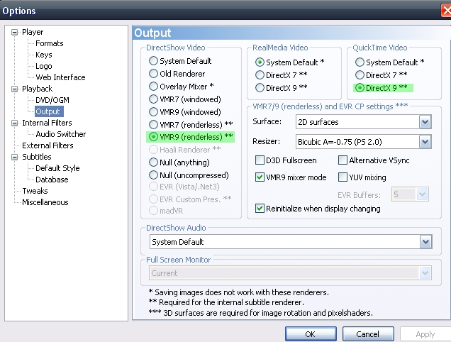

You might need to update your Nvidia video driver and DirectX. You'll know it's working when you see this:
"Quality is cool, but don't forget... Content is King!" -

Try MPCHC
In the options => internal filters => transform filters => look under h264/avc (dxva) , checkmark it to enable it and double click it to set the options. Set the decoding thread number to the number of cores (2 for dual core), and look at the video card to see if it regards your video card as dxva compliant
Not all material is dxva compliant. If the source has too many reference frames, or b-frames for example, it can break dxva compliance. If this was x264 encoded, it need proper settings including vbv buffer values to be completely compliant -
