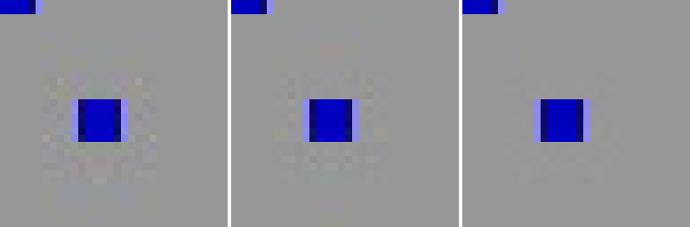

    You have to step Xvid down to quantizer = 1 to prevent DCT ringing artifacts. At that point there's so little compression there's no point in using Xvid.
    You can enable Xvid's deblocking and deringing features for playback on your computer. That will reduce the artifacts when playing the video. But you don't have that control on other peoples players, or standalone players.

    Sure, he can reduce the DCT ringing in his source, but Xvid compression will recreate them. The sharper the source, the worse the problem will be.
    A pristine source (all images are 8x point up-sized, cropped from a larger frame, all I frames):
    encoded with Xvid (Q=3, Q=2, Q=1), played back with Xvid's deringing feature disabled:
    With the decoder's DeRinging feature enabled:

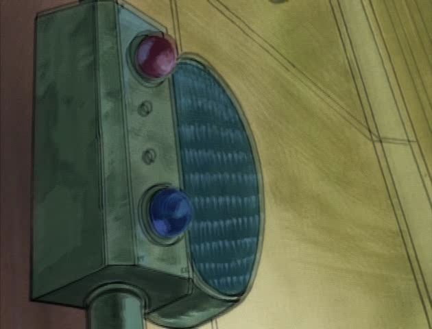

  17. I looked at your source, and the blends in your encode are from your poor IVTC or deinterlacing method
    Here is an example of what I mean, from your encode. This isn't present when you use avisynth to IVTC (using TFM().Tdecimate() )
    The minor line noise (or mosquito noise) is present in the source. But it's made worse by xvid compression, or whatever settings you used. Most people would filter it slightly before encoding. If you can't see it, pay attention to the scenes where the character is running, and look at the grey patches near his shoulders, and neck. It will look similar to those examples jagabo posted earlier. Most anime fans detest this type of noise, but again, this is personal opinion
    In this zip file, are 2 .pngs, 1 of the source, and 1 filtered. Flip back and forth, and pay attention to the grey areas mentioned earlier, the right armpit. These are uncropped 1:1, and not resized, and before any compression.

  18. Member darkdream4's Avatar
    Jan 2010
    Your filtered looks great compared to the other one. I wish I knew how ya did it. I also detest those things I noticed that your filtered gotten rid of. I was trying to get rid of the noise myself but couldnt get it all. Yours looked pretty amazing to me.
    Thanks for all the info and help. Apparently trusting the VirtualDub or VirtualDubMod app to deinterlace or IVTC is a big mistake. I guess Ill have to learn scripting.

  29. Originally Posted by jagabo
    I have no intention of going down to the pixel level for this, but I have zoomed in a bit. I've enclosed 6 pics in a ZIP file, after reencoding the sample 5 times (one of the pics is of the uncompressed source). My contention is that the 2 main matrices used for XviD are designed for heavy compression - for compressing movies down to a CD or 2. But with better matrices (and a larger size), XviD can do a decent job without creating much noise around edges. Anime is a good test, because of all the hard edges it has.
    1.Uncompressed-Unencoded.png It is this script opened in VDubMod and a PNG taken, then the PNG is zoomed in. The original script:
    TFM(D2V=("E:\Test\test.d2v"),PP=0)
    TDecimate()
    Crop(6,0,-4,0)
    LanczosResize(640,480)
    The zooming script for the PNG:
    Crop(166,184,-200,-90)
    That's the base. The original VOB sample was 34.8 MB in size.
    2. Fox-Quant3-Unfiltered.png That same script encoded for XviD, a pic taken and zoomed in. I'm using the same frame that poisondeathray used. The matrix used is sometimes called Fox Home Theater and is commonly used on DVDs. The reencoded size is 18.7 MB
    3. Fox-Quant3-LightFilter.avi Same matrix and script with the addition of some light filtering, similar to what PDR suggested:
    Deen()
    Dull=Last
    Sharp=Dull.LimitedSharpenFaster(ss_x=1.25,ss_y=1.2 5,Smode=4,strength=350,soft=30)
    Soothe(Sharp,Dull,25)
    This is, in my opinion, the best of the bunch, and better than the source as some of the noise has been removed, without the details taking much of a hit. Size is 17.5 MB.
    4. MPEG-Quant3-Unfiltered.png Everything the same as pic #2 except for using the common MPEG Matrix. Size is 8.46 MB.
    5. MPEG-Quant3-LightFilter.png Everything the same as pic #3 except for the use of the MPEG matrix. Size is 8.72 MB. Both pics 4 and 5 have a greatly increased amount of noise which stands to reason when reencoding to a lossy format using tremendous compression.
    6. Fox-Quant3-HeavytFilter.png Filtered it differently, following the script (pretty much) in the link I posted earlier:
    Deblock()
    dfttest()
    FastLineDarken()
    deen("a3d",4,8,9)
    Spline36Resize(last.width*2,last.height*2)
    aWarpSharp(depth=12,blurlevel=4,thresh=0.2,cm=1)
    FastLineDarken()
    aWarpSharp(depth=6,blurlevel=4,thresh=0.7,cm=1)
    FastLineDarken()
    DeHalo_Alpha()
    fft3dFilter(bt=3,sigma=8,sharpen=1.3)
    Spline36Resize(last.width/2,last.height/2)
    Slow as hell. It pretty much wipes out the noise, but most of the texture detail on walls and elsewhere as well. Size 13.6 MB.
    Conclusion? A Custom Quant matrix won't create the noise that the 2 common matrices will. The size increases, and rather than getting a file roughly 25% the size of the source you get one roughly 50% the size. The file size savings is still considerable. Some standalones won''t play XviDs that use Custom Quant matrices. Those with ESS chipsets won't. I believe that those with Mediatek chipsets will. It's been several years since I tested that, though. HTPCs and the similar boxes that feed into TV sets shouldn't have any problems at all. I'm not sure, jagabo, if you're saying that XviD by its very nature creates noise or if using the common settings and matrices will result in noise being created. I'm saying that less compression, but without having to go down to quant 1, can result in a video that for all intents and purposes is transparent to the source.
