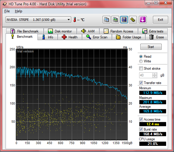

Here's the read or if this is what you wanted to see. Am I supposed to be able to do the write test, because I can't it says unless I remove all partitions.
Here's the write I just deleted the partition and will format again later. What could cause the big drop in there?
Would I need a new RAID controller? If so name some that are good and not expensive. -
