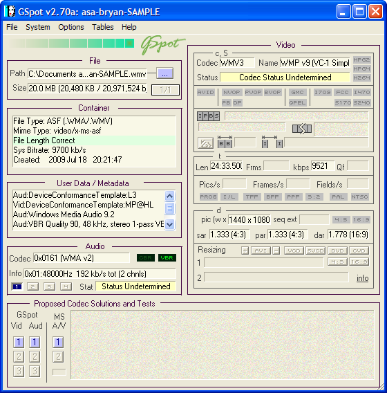

gspot, after thanking me for finding it, tells me that the file(s) in question are 1440x1080 with a DAR of 1.333 (4:3) and a PAR of 1.000 (1:1), which is an improperly encoded 1440x1080 file, it should have a PAR of 4:3 for a DAR of 1.78.Originally Posted by poisondeathray
oddly enough, even manually setting the source PAR as 1 within my encoder and the output as 1440x1080 with either 4:3 or 16:9 PAR results in an improperly encoded file, in the case of the former it comes out just like the source, in the case of the latter it comes out with black borders all the way around, a truly crappy encode (basically it comes out letter boxed and pillar boxed).
the only thing that seems to work is jagabo's suggestion of basically "lying" to the encoder and telling it that the source has a PAR of 16:9, it doesn't make any sense to me, but that's the way it is.

In gspot 2.70a, it shows a PAR of 4:3 and DAR of 1.78. Are you using a different file?Originally Posted by deadrats

You could do it through avisynth, which always assumes square pixel for decoding, then specify AR when encoding or in the container (depending on what format you are using)the only thing that seems to work is jagabo's suggestion of basically "lying" to the encoder and telling it that the source has a PAR of 16:9, it doesn't make any sense to me, but that's the way it is. -
deadrats - you seem to be using words you don't understand. the PAR - pixel aspect ratio - of a 1440x1080 widescreen video is 1.33333 so it's not "lying" to the encoder, but telling it to treat the video properly.
and no, before you whine that 1.33333 is 4:3, it's not in pixel aspect ratio terms. par only relates to the shape of the pixel not it's output on a monitor.--
