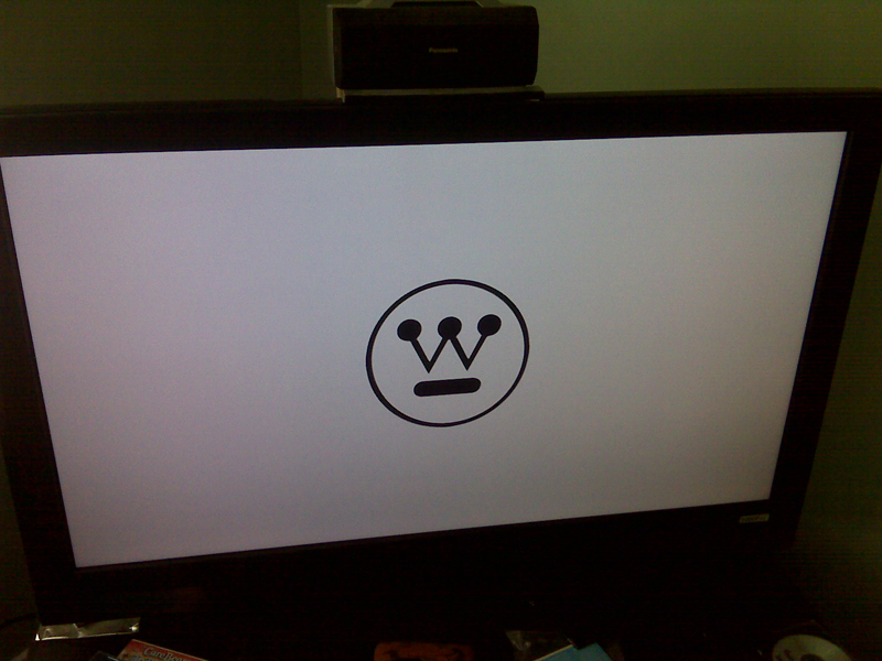

It appears to be a simple frame. It's used to show the logo on my TV when it turns on.
I'll give Virtualdub a try.
Actually I was able to extract the image to jpg before the YUVTools trial period ran out. I'll attach it.
The image shows up with a black background with a whiteish logo on the tv though.

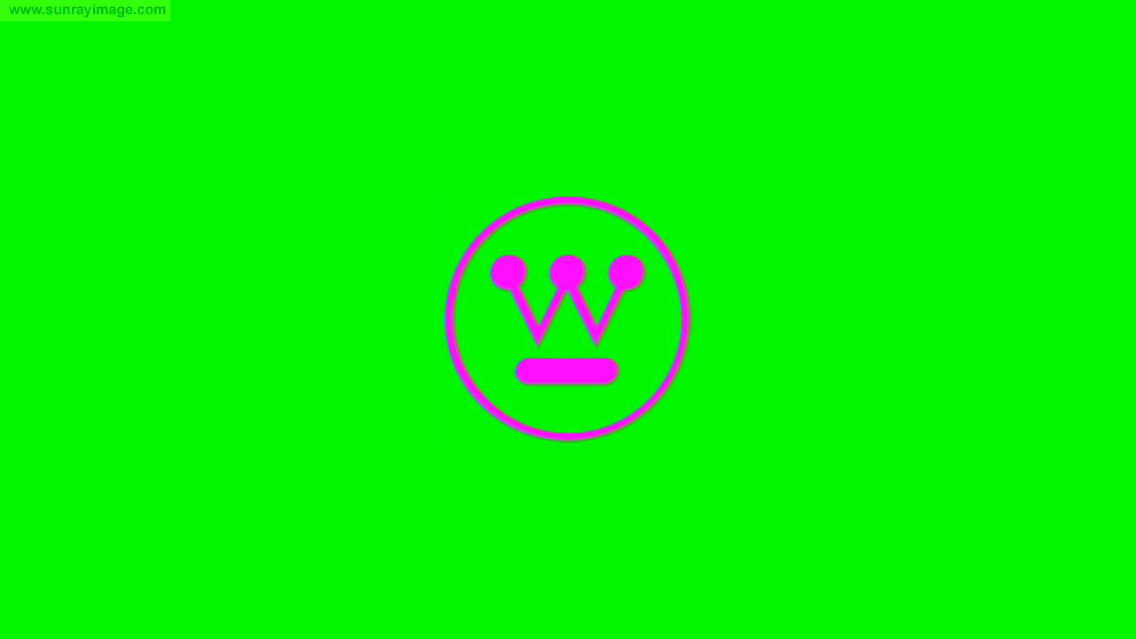

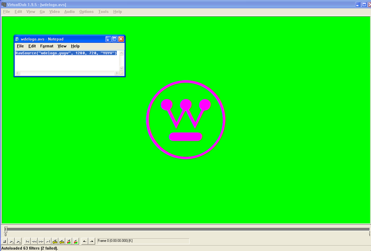

Opened with VirtualDub and AviSynth (AVS script pictured):
I don't know how you're going to export it in the same format though.
------------ later...

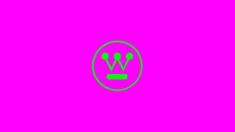

I worked out a way to export a frame. It's a bit complicated though. Here's a sample (colors inverted), see if it works:
inverted.yuyv -

Here's the result of the inverted.yuyv. The colors are inverted from the normal black background and white logo.
Now how can I go about changing the image myself?

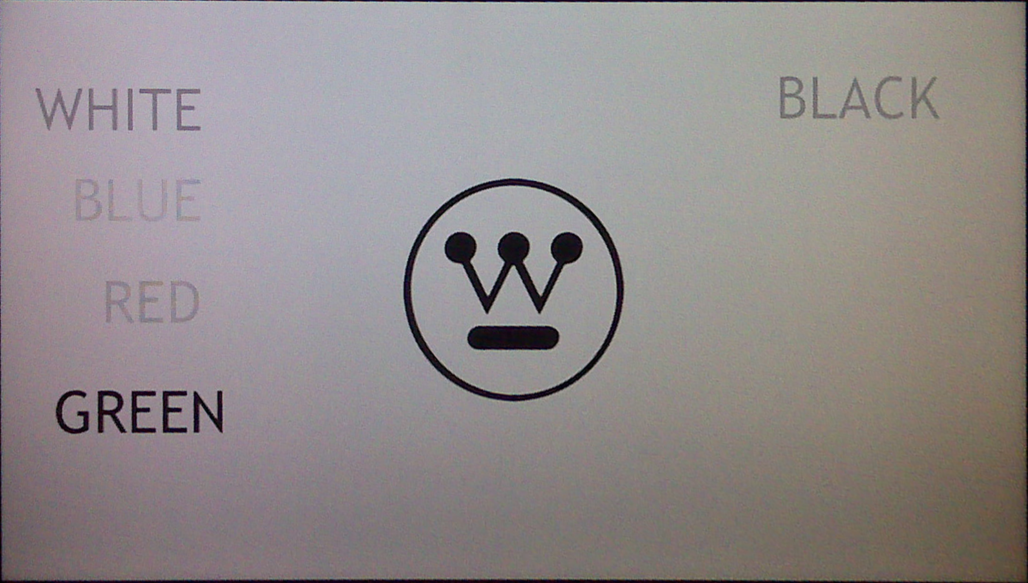

EDIT: Here's the result of the test image I put on the firmware, looks like the tv only does Greyscale, where green = black and pink = white.
Looks like you got it sorted out so I won't write up what I did. But I did a similar thing with VirtualDub's built in hex editor. Try exporting a real image and see what you get. Maybe the device is simply converting whatever image you give it to grayscale.
By the way, there is an extra 16 bytes at the end of the YUYV video data. It appears to be 4 long words in big endian format. The first long word is the width of the image (1280), then the height of the image (720), then the number of bytes per scanline (2560). I don't know what the last one is but the value is 512. -
Both white and black come out black when displayed on the TV, and pure green, RGB(0,255,0) is a light gray. I'll get it.

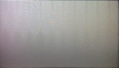

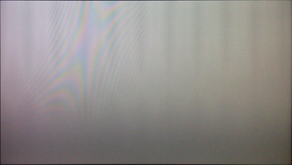

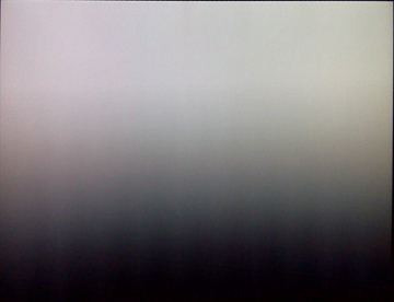

Well here are the 3 gradient images I tried, RGB values (255,0,0) (0,255,0) and (0,0,255)Originally Posted by jagabo
Red
Blue
Green
The only one that wasn't all white was the green.
