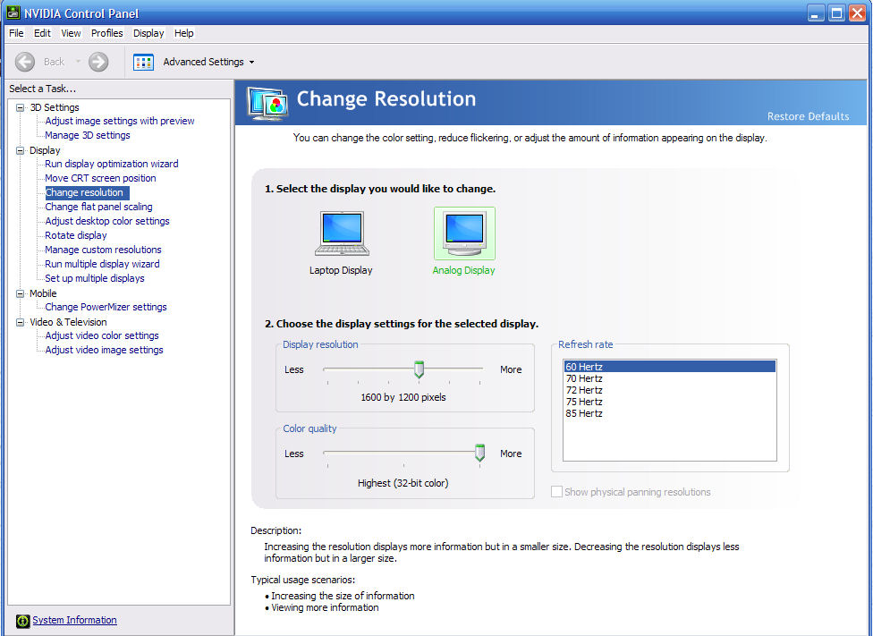

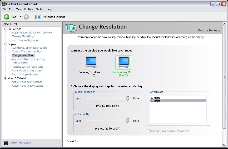

I rebooted into XP. This machine has
GeForce-9800GT (XP driver 1/14/09)
1. Samsung computer monitor 1650x1050 (connected DVI-D)
2. Samsung HDTV 1920x1080 (connected VGA ... alternate connection is DVI-D to HDMI).
The NVidia control panel looks like this
"set up multiple displays"
Note: Configured independently is checked.
Then, "Change resolution"
Yours should top out at 1360x768 or 1366x768.

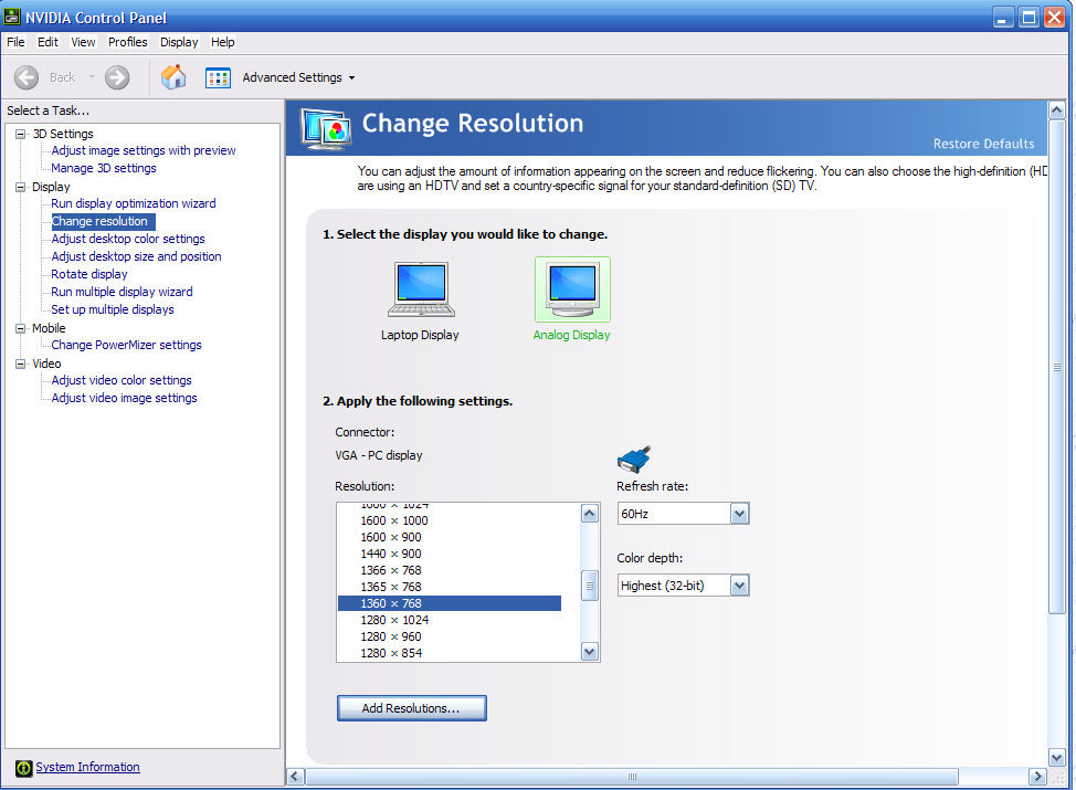

okay, I fixed it. I installed some 3rd party drivers. X-treme G, 190.something or other. After a restart all resolutions are available to me and I could choose the correct one. nvidia is way behind on their official drivers.
Thanks guys! -
