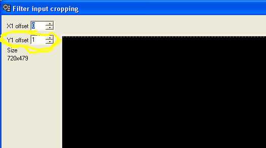

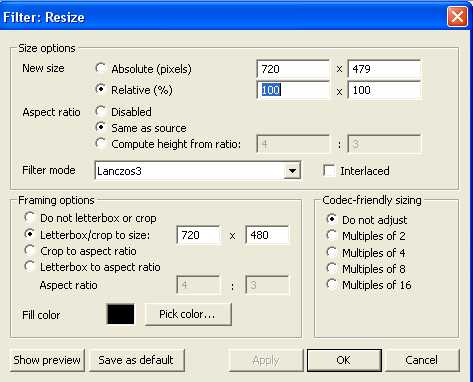

If you can't override the field order in Studio you can reverse it in VirtualDub by shifting the entire frame up (or down) by one scan line. Use the Crop function to remove one scanline from the top. Use the Resize filters letterbox option to add one scanline to the bottom. -
No such animal in PS9.Originally Posted by jagabo
I'll go through this to verify I'm doing what you're referring to.If you can't override the field order in Studio you can reverse it in VirtualDub by shifting the entire frame up (or down) by one scan line. Use the Crop function to remove one scanline from the top. Use the Resize filters letterbox option to add one scanline to the bottom.
The only way I see to invoke cropping is when there's a filter loaded so since you mention the resize filter, I'll load it.
This is what you're talking about?
However, when you say Use the Resize filters letterbox option to add one scanline to the bottom
It's not clear to me where in the filter you specify adding it to the bottom. And what should I be adjusting, the size options or the framing options?
What you have there looks exactly right. If you look closely at the input and output panes you should see that one line has been removed from the top, one black line added to the bottom.
By the way, the Letterbox option doesn't let you specify how much gets added to the top vs the bottom. I just happen to know that adding one line will result in the line being added to the bottom.

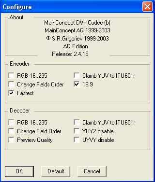

The problem I believe is in Pinnacle Studio's re-rendering to DV-AVI. The problems seem to be when taking the original files, editing them together as one DV file - or just re-rendering to DV as you saw with the "through_pinnacle.avi". The original file that looks okay was captured through Pinnacle - and I guess it's technically really just a transfer, with the camera dumping the bitstream to the hard drive, using PS -via my Soundblaster Audigy's Firewire port. PS9 doesn't seem to mangle it at that point.Originally Posted by jagabo
In the examples above, I started with a piece of one of the original source files as dumped to the h/d directly from the cam. "original.avi" which as you see looks okay is simply a piece of that file direct stream copied via Virtualdub.Did you start with original.avi?
No other filtiering, using Mainconcept DV codec 2.4.16Did you do any other filtering? What DV decoder did you use? What DV encoder?
Here's the MainConcept configuration window as it's currently set.Did you force a colorspace on the input or output (Video -> Color Depth in VirtualDub, or maybe in your DV codec)?

I made a DVD out of the project and it looks fine on a TV. The problem seems to be when Pinnacle creates a DV avi file. I did a preliminary test of a short segment checking "change fields order" on the Mainconcept configuration window and that seemed to get rid of the problem, at least on initial inspection. Generally the only reason I would create an AVI would be to then create an mp4 or other file to put up online or to use that AVI as part of a larger Pinnacle project.
And actually, now that I think of it, I may have also had problems when applying filters in Vdub. If checking the field order box makes the difference, maybe I just have to remember to do that. -
[s:f75b9d74fa]So far it appears this field order setting on the codec configuration window is the key. I just made a DVD out of a test file that had been run through Pinnacle but this time with the change field order box checked - the file checks out with the Bob Doubler test, and the DVD looks fine on the tv.[/s:f75b9d74fa]
Nevermind, I see there are severe problems with a file created that way.
