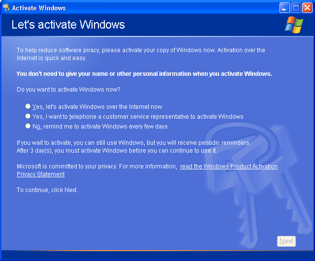

So as I was saying.. I was trying to re-install my ADVC-100 on my xp home (it used to work before) and in the process of trying various 1394.sys and a few other driver files, including windows 98 1394.sys drivers--anything, to get this damn advc to work again, I finally got the dreaded and feared activation message. Mind you, this xp home computer is not connected to the internet. It is intentionally a non-internet computer for the purpose of protecting the integrity, etc.

Here's your bottom line - either activate Windoze or reinstall the OS. There's no "magic" to make activation not occur and as you found out almost anything can turn it on. Whatever you read was wrong. I've heard of people simply putting in additional memory and being asked to activate it. -
Do this, it will work.
1. Check second option.
2. Click next, you will get a customer service number.
3. Have your upgrade CD number ready.
4. Call customer service.
5. Calmly explain everything. They will give you a long activation number -

Yes, just wanted to let you all know that I have successfully re-activated my xp home. I was expecting to argue with the rep but instead, got an automated one, that, I like that
You see, admittingly, I seem to have lost my original cd and was chewing on my nails with fear over this activation nonsense, but out of whim I decided to click on the activation's [NEXT] button to see what would happen, hmm.. and thats when it popped up my old activation ID's, then I took another leap, and reached over for the phone, and, the rest is history.. I like that!
