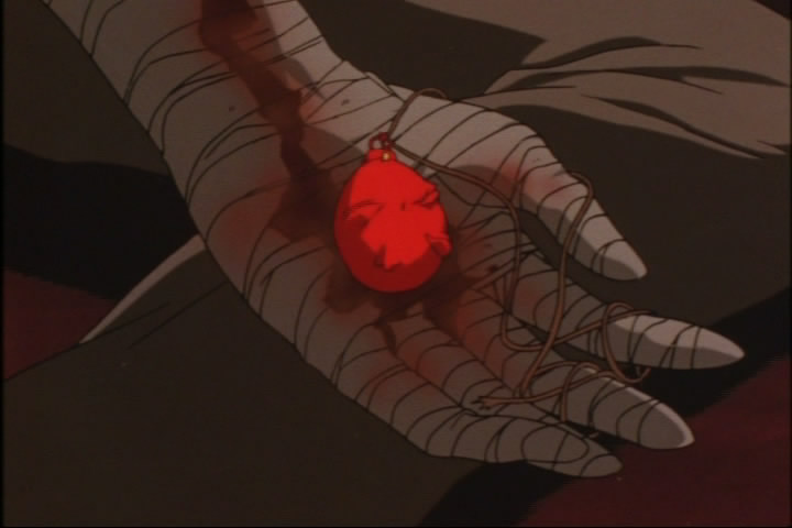

    I first tried to ivtc the trailer using the "reconstruct from fields- adaptive" setting in VDM. I looked in the frame rate info of the finished AVI file and it said the current fps was 23.97, which would lead one to believe that the footage had been successfully IVTC'd to progressive. Yet the end result still has artifacts like this:

  14. Those aren't regular combing artifacts. They are improper handling of interlaced chroma channels. It probably happened when you converted the original file to Huffyuv. VirtualDub does not handle interlaced YV12 properly.

    You need to open your original file in AviSynth and ConvertToYUY2(interlaced=true) before giving the video to VirtualDub. Then hope the problem isn't in your original file.

    Edit: I IVTC'd the YUY2 footage and all the combing is gone. The only thing is, the video and audio skip at random times during playback in virtual dub. Hm, i did use rate=24 in the TDecimate().
  21. VirtualDub is not optimized as a video player. In addition, filtering with AviSynth CPU usage may be too high to get smooth realtime playback. Just convert your video and test the resulting file.
  22. Member
    Dec 2009
    The IVTC worked but there is still blurring like:
