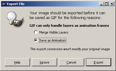

    When saving, you are presented with the choice of keeping it animated or flattening it down to one layer. See screenshot:

    I didn't get that option - in fact, it looked as though GIMP had already reduced it to one frame when I tried resizing it.

    Just installed the latest "plain" Gimp 32-bit version 2.6.7 on Vista 64. Works fine and was able to resize animated GIF in the same way as GimpShop. Maybe your version of gimp is outdated........
