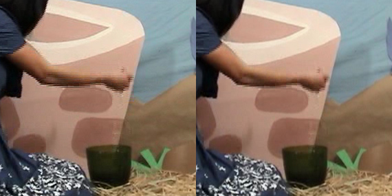

I now exported the movie using Adobe Media Encoder. NTSC, 29.97 fps, lower field order -- all settings match the ones of the original DV footage. But I still get interlacing/jagged edges.
Please see the attached image: on the left is the orignal MPG produced by Adobe Media Encoder (from inside Premiere Pro) as shown in VLC, on the right is the same frame deinterlaced using blend mode in VLC. It still looks a lot more jagged than the original footage.
Is this because I'm using film effects and color correction on the footage? What am I doing wrong?

Part of it looks like macroblocking from low bitrate, which might affect the deinterlacing. What export bitrate are you using? Try increasing it
Footage with motion and noise are the parts are the most negatively affected by low bitrate, and the picture will break apart with macroblocking. If the deinterlacing algorithm used cannot compensate for that, it might what you are seeing there. If you notice the edge of the sleave and lower part of the arm has macroblocking the in the left picture, whereas the other edges like the sand grains, dark edges do not. In the right picture, only those areas which had macroblocking are affected, and the other edges that didn't have macroblocking look cleaner. To test this, if you did the same export with Huffyuv (interlaced), and still got the artifacts, then it's NOT due to low bitrate MPEG2 -

That looks about right. VLC's deinterlacer isn't that good. The residual jaggies are aliasing artifacts from a low quality deinterlacer algorithm because it's meant for real time function in software mode
Use an avisynth deinterlacer if you want very high quality. The high quality ones work less than realtime (ie. very slow and CPU intensive) and are meant for offline processing. The DVD player should give decent deinterlacing results as well (I think), as it's hardware based and meant for deinterlacing
If you upload a sample clip of this section, I think I can demonstrate this -
