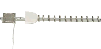

You need a fixed directional antenna. Hopefully you don't have trees or other obstructions.
http://www.radiolabs.com/products/antennas/2.4gig/14eleyagi.php
but connecting that to a laptop is near imposible.
Read the Radiolabs overview.
http://www.radiolabs.com/Articles/wifi-antenna.html
