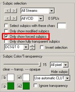

I don't quite understand, though. Are you converting the DVD movie to some other format? If so, and if VobSubs are OK, then what I just described should be enough. If you plan on hard coding the subs into the video, the VobSubs are enough. If you're keeping it as DVD, getting back the menus and menu commands with the original subs will be enough. If you just want to save out the forced subs, one way would be to extract the SUP file from the movie (PGCDemux), open it in DVDSubEdit and check the box in the picture before going File->Save All Modifications. You can then convert the edited SUP file to VobSubs instantly using SubtitleCreator and OCR from that if you need to.

When I select this box the entire movie becomes grayed out. I guess there are no forced subs. However, I cannot find any other subtitle tracks than the one I already ripped. I'm still uncertain as to why this is the case.Originally Posted by manono -
